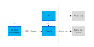

We burn the key to the HS tda4vm by SD-card(MMC1 interface) boot mode in our production line, the flow diagram is as below,
successful log
I got a sample from factory and it seems  efuse failing,
  1. Power consumption: 200mA@12V
  2. all of the PMIC output value is correct (1212+1111)
  3. The GPIO9 and Vpp  are low level while retrying to write to efuse.
  4. the MMC1_CLK and date line are keeping high level all the time
  5. and there is no log file recorded for this sample.
Could you help to reply,

    Please share the failure logs. What point in key writing is failing?
    How did you confirm that?
    - Keerthy
  • Hi Keerthy
    The MCU_UART0 printed gibberish while writing OTP key. Please check the log file as below,
    The ECU cannot run normally in SD and QSPI boot mode. And the power consumption is different.
    •  SD boot mode: 360mA@12V
    •  QSPI boot mode: 200mA@12V
