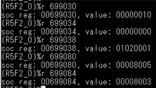

We face the VPAC process speed very low issue when we switch to the ECU board.
The MSC takes almost 20ms per frame on ECU board. We check it only take almost 3~4ms On EVM VE board.
Then we use the k3conf tools to dump all the CLK and it seems the CLK becomes very low.
Please note that the ECU board has change the EXCLK from 19.2MHz to 25Mhz.
Could you help analyze the issue. It is very urgent. Thanks.
