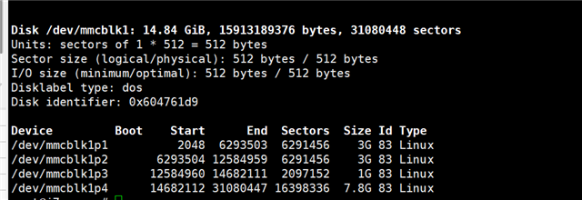

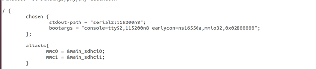

The customer tried to modify the device tree file and then recompile the Linux kernel without taking effect. The sequence of operation is as follows:
1) Modify SDK-path/board-support/Linux-5.10.162/arch/ARM64/boot/DTS/ti/K3-j721e-common-proc-board.DTS. Add aliases at:
2) Rebuild Linux and copy the Image and DTB files under the generated boot folder to the root FS partition boot folder under EMMC.
3) Multiple reboots, with only one MMC device (only EMMC without SD card), the /dev/mmcblk1 condition still occurs:

HI Cherry
The customer is just using emmc and they dont have SD card ?
They want to make sure that emmc get dev/mmcblk0, am i correct ?
Help share the dtb they are using
Diwakar
Hi Diwakar,
Yes, they are testing on the evaluation board with the goal of removing the SD card, using only EMMC, and fixing the device number of the EMMC to /dev/mmcblk0. The DTS file and the DTB file are as follows:

Hi Cherry
If they are not using sd card they can remove the sd node (main_sdhci1) from the both k3-j721e-main.dtsi and k3-j721e-common-proc-board.dt device tree.
also remove alias for mmc1 = &main_sdhci1;
