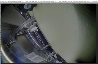

For TDA4VH  surround  camera   test demo .
The first time I  test the capture is normal. After exiting the test demo , if I run the demo without reboot the TDA4VH, there will be an exception in the front of the saved image, such as NOK.png. Please help analyze .
The first image is problematic, as if the upper part of the image has been segmented. The second image is OK .
1) If you reboot the device and run the test demo again, the saved images are OK .
2) The configuration of the camera driver will only run during first initialization.
3) When exiting, the following resources were released and no obvious errors were found
4) The code for releasing resources can be found in the attachment log for the following fields: app_run_graph is done

  • Hi
    In the attached log, I couldn't find any exception. Could you please let me know what is the exception seen?

  • Hi zheng,
    Do you also reset camera and deserializer between two runs? This looks like camera and deserializer going out of sync..
    Brijesh

  • Hi zheng,
    Most likely, capture output is graph parameter in your case, so you are getting capture buffer mapped in the application space and could get access to the captured frame. You can use it to check the buffer content. Most likely it would be same as what is getting displayed.
    This is coming due to some sync issue between sensor, SERDES, CSIRX.
    Brijesh
  • Hi Brijesh :
    I think I found the reason: the LDC node was created, but it was not properly released after the process ended.
    The following code does not use 1U==obj->ldc_enable  is used to control, but other LDC logic codes use this variable for control
    vxSetNodeTarget(obj->node_ldc, VX_TARGET_STRING, TIVX_TARGET_VPAC_LDC1);
    My question is that , are there any related logs or device nodes that can view the created nodes or resources?
    I didn't see any obvious logs in the log.
    Thank you!
