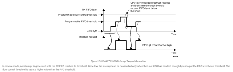

Datasheet says there is programmable trigger for uart. That means programmable fifo interrupt.
if fifo has more number of bytes than trigger level, interrupt occur.

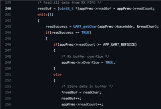

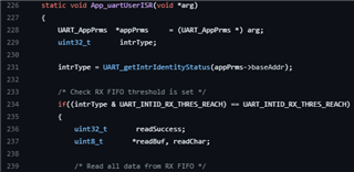

UART_echo_low_latency_interrupt example :
This example uses user managed interrupts.
the example calls callback function everytime char arrived and writes as echo. No matter what is tx and rx trigger level on sysconfig.
That is not what i expected. techical documents says interrupt will occur when there are more bytes than trigger level in fifo.

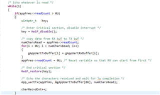

UART_echo_callback example:
in this example there is transaction parameter for Uart_read function. transation has count for trigger level variable.
it is reads every byte like other example but prints back when tx triggered.
i assume Rx trigger is not working but Tx does. Because interrupt occurs for every byte for reading but only occurs if its above triggered level for printing.

TRM says activate dma mode with trigger level.
In sysconfig, there is no trigger level option when dma selected. Thats why i though trigger level is not working with dma. i need to set it up interrupt.
