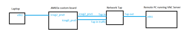

My setup here is as follows:
ICSSG2 I enable auto packet forwarding with the following register settings:
0x0B232000: 0x259
0x0B232010: 0x000B1201
0x0B232004: 0x251
0x0B232014: 0x000B1301
0x0B233000: 0x1042D
ICSSG0 I leave in the default configuration.
I then start two TCPdump instances in my am65x board, one sniffing ICSSG0_PRU0, and one sniffing one of the autoforwarded connections, ICSSG2_PRU0. I get identical results between the two; EXCEPT the second byte of the destination IP address when capturing on the autoforward side occasionally gets screwed up! It seems pretty random as to when it happens, and it also seems random as to what gets written to that byte. It’s as if there’s a pointer that isn’t treated properly, and it occasionally overwrites that byte. I’m unsure why that would happen only with the autoforwarding enabled though. The rest of the packet data looks to be identical between them, though I’ve only done random spot checks at this point. I can provide the two capture files if it would be helpful.
Any ideas of where I could look to solve this issue? Or any ideas what may be causing this?

  • Hi Rimika,
    So if you look at my test setup from the first post, my AM6548 board is not the recipient of the data at all. It's just sniffing the data both with a tap and through one of the interfaces that is using auto packet forwarding. The setup is highlighting that when packet auto forwarding is enabled, the PRU eth driver (I suspect at least) is not handling the traffic correctly. Both captures are from the AM6548 board, so clearly it is capable of capturing at gigabit speeds as shown with the testTap.pcap file. I can try to change the interface that is using autoforwarding to use switch mode though if you think that might be useful. How might I do that?

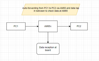

  • Ah yeah there is a misunderstanding on what my goal here is. I want to auto forward the data to another destination while simultaneously capturing it on am6548 end. The auto forward feature with optional PRU snoop described in TRM section 6.5.11.2.1.1 seems to accomplish this. Using the register settings I posted in my initial post, this auto forwards every packet without error. And again with my test setup described in the first post, I show that it does indeed auto forward packets correctly, and I can capture them all correctly when using a network tap connected to the am6548 board.
    My issue is that I do not want to use the external network tap to sniff the network, I want to use the PRUs that are auto forwarding the packets. And this is where I see my issue with the sniffed packet data corruption. Again the actual packet data on the network is just fine, it is just the data that I sniff gets incorrectly read it seems. Interestingly enough, if I force both PRUs to 100mb/s speeds using ethtool, using the same packet forwarding register settings I see no corruption in the captured data. All captured data from them looks good. So this only happens at 1gb/s speeds.
  • Hi Keith,
    This is our target?
    Thanks and Regards,
    Rimika
  • Hi Rimika,
    Yes that is the target there! And specifically at 1GB/s speeds.
