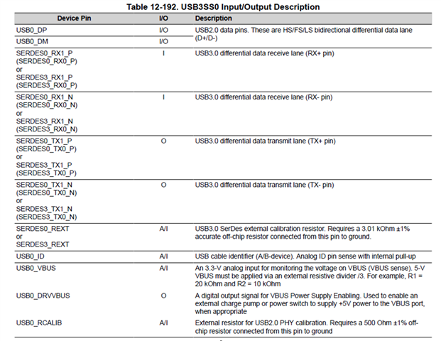

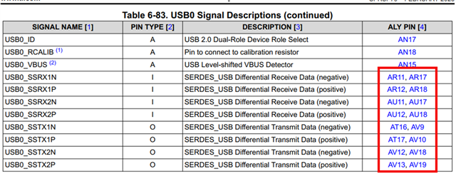

We see on the datasheet that the ports that can configure USB3.0 are TX/RX 2 and 3 of Serdes4, But in TRM, The ports in this document are TX/RX 0 and 1 of Serdes3.
BR,
