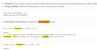

Also when calling K3ImageGen.sh we give the core id 4 as shown in the User Manual. However in case we oped that file we see that the ID4 is an MPU and not the MCU.
Is the documentation under User manual incorrect or the list in K3ImageGen.sh?
