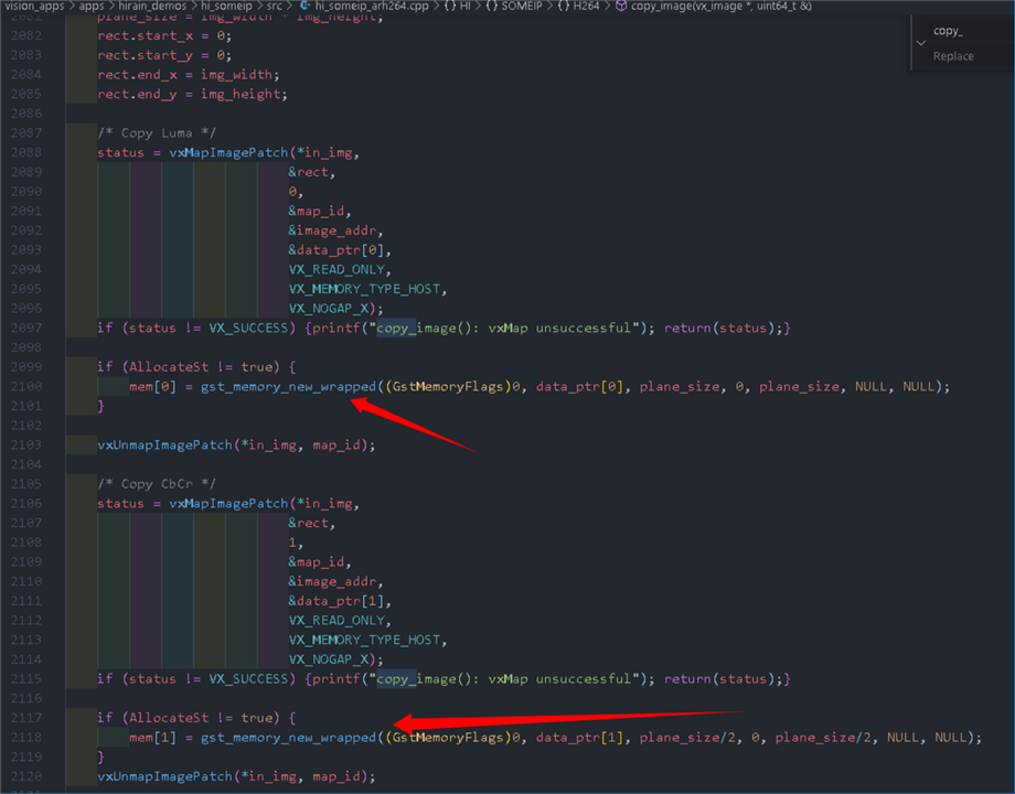

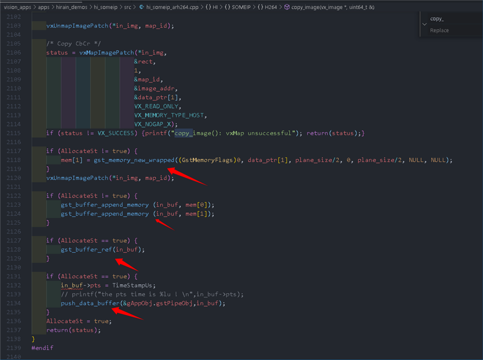

Hello, partner:

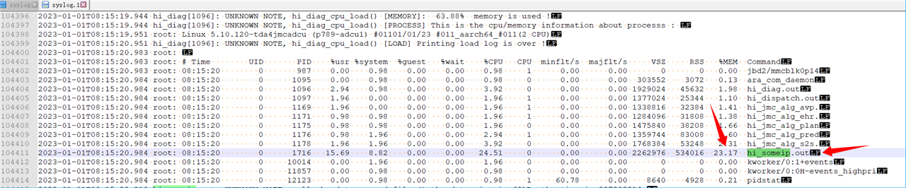

   We have a problem, When we use Gstreamer for encode frame to h264, the "hi_someip" process memory consumption continously increases until the process dies.
   the code is as follows:
the  tda4 log is as follows:
Please give some advice, thanks!
