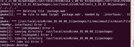

there is no ctg6x in the sdk11,but the makefile needs it.
when i rebuild the omx_vs, i found there's no folder named ctg6x ,and only ctg470. i'm wondering if there's wrong with the package.
after i modified the makerules, about the  path.
the console shows can't find ctg6x, then i copied ctg6x from sdk09 to sdk11.
then the  step passed,but next,it shows:
i don't know why it happens .does it about the XDCPATH?
