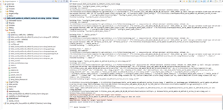

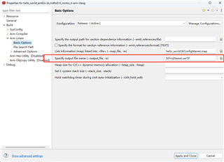

Customer wants to build hello_word_am62x-sk_m4fss0-0_nortos into .xer5f file, can it be realized by directly modifying the output file name in ccs? After this modification, the error is reported as follows.
  • Hi Nancy,
    The customer would also need to modify the extension from .out to .xer5f in OUTFILE variable in CCS example makefile (makefile_ccs_bootimage_gen). The exact change is shown below

    -OUTFILE=$(PROFILE)/$(OUTNAME).out
    +OUTFILE=$(PROFILE)/$(OUTNAME).xer5f
