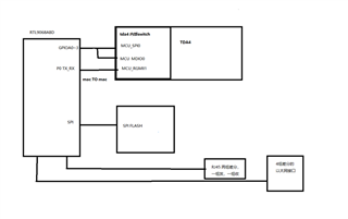

1. This is the block diagram of TDA4 and RTL9068 connection.

Rtl9068 status:
GPIOA0~3 connected to the 9068 through the usbio adapter board has burned the 9068 firmware to the flash.
The 9068 uses the automatic startup scheme. The firmware driver is downloaded to the spi flash and starts by itself after being powered on. No need to write driver files.
5. Test situation:
Now 9068 and tda4 are connected in MAC-to-Mac mode. It is connected to the mcu rgmii1 port of tda4. At present, the txc of 9068 and the txc of tda4 are both 125M clocks.
In addition, rgmii adopts the non-auto-negotiation mode. However, what we see through ethtool is auto-negotiation mode, and it is not clear how to change it. As shown below:
6.How to configure the rgmii port of the mcu on the linux side and set it to the non-auto-negotiation mode of mac to mac?

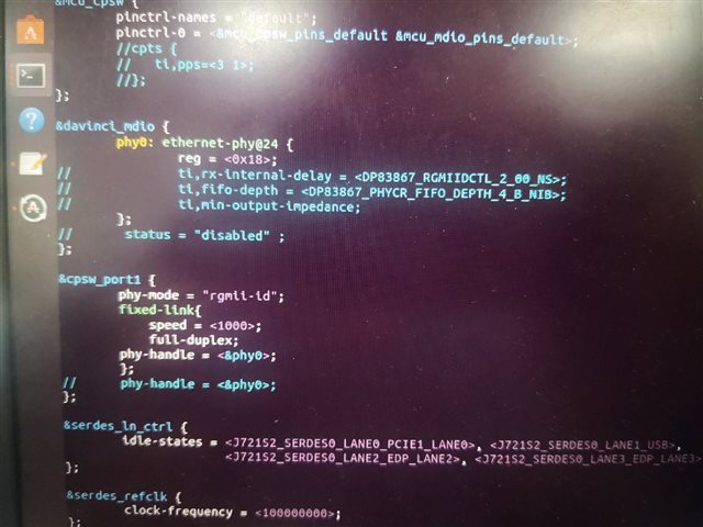

    Can we abstracting the RTL9068 chip as fixed phy to w/r reg of RTL9068 throw mdio.
    Yes, PHY is configured in Fixed-Link mode without PHY address. MDIO driver can't bind to PHY.
    We may not be able to read PHY registers in Fixed-link mode, until you register PHY with valid address.
    Sudheer
  • We have try to config fixed-link like this ,but can not work too.
    Can you show the example code to add phy in fixed-link mode?

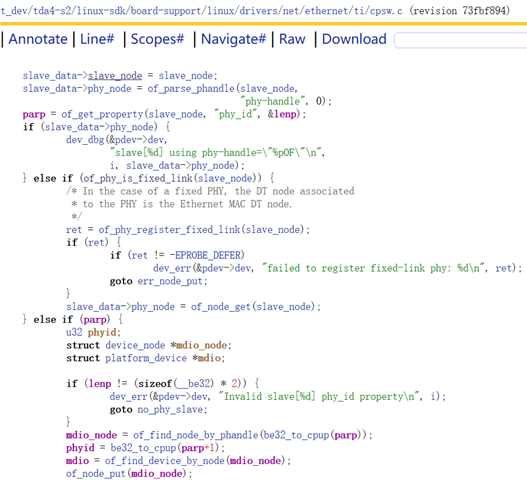

  • We found fixed-link node can not use with  phy dev together.Is there any patch to fix this cpsw driver problem?

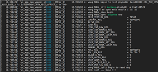

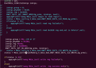

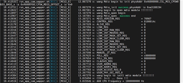

    • #include "mdio_module.h"
      #include <app.h>
      #include <utils/console_io/include/app_log.h>
      #define CPSW_MDIO_OFFSET (0x00000f00U)
      #define CSL_MCU_CPSW0_NUSS_BASE (0x46000000U)
      #define CPSW_RD(offset) (*(uint32_t *)(CSL_MCU_CPSW0_NUSS_BASE + offset))
      void dump_regs(){
      appLogPrintf("MDIO_VERSION_REG = %x\n",CPSW_RD(0xf00));
      appLogPrintf("CONTROL_REG = %x\n",CPSW_RD(0xf04));
      appLogPrintf("ALIVE_REG = %x\n",CPSW_RD(0xf08));
      appLogPrintf("LINK_REG = %x\n",CPSW_RD(0xf0c));
      appLogPrintf("LINK_INT_RAW_REG = %x\n",CPSW_RD(0xf10));
      appLogPrintf("LINK_INT_MASKED_REG = %x\n",CPSW_RD(0xf14));
      appLogPrintf("LINK_INT_MASK_SET_REG = %x\n",CPSW_RD(0xf18));
      appLogPrintf("LINK_INT_MASK_CLEAR_REG = %x\n",CPSW_RD(0xf1c));
      appLogPrintf("USER_INT_RAW_REG = %x\n",CPSW_RD(0xf20));
      appLogPrintf("USER_INT_MASKED_REG = %x\n",CPSW_RD(0xf24));
      appLogPrintf("USER_INT_MASK_SET_REG = %x\n",CPSW_RD(0xf28));
      appLogPrintf("USER_INT_MASK_CLEAR_REG = %x\n",CPSW_RD(0xf2c));
      appLogPrintf("MANUAL_IF_REG = %x\n",CPSW_RD(0xf30));
      appLogPrintf("POLL_REG = %x\n",CPSW_RD(0xf34));
      appLogPrintf("POLL_EN_REG = %x\n",CPSW_RD(0xf38));
      appLogPrintf("CLAUS45_REG = %x\n",CPSW_RD(0xf3c));
      appLogPrintf("USER_ADDR0_REG = %x\n",CPSW_RD(0xf40));
      appLogPrintf("USER_ADDR1_REG = %x\n",CPSW_RD(0xf44));
      appLogPrintf("USER_ACCESS_REG_0 = %x\n",CPSW_RD(0xf80));
      appLogPrintf("USER_PHY_SEL_REG_0 = %x\n",CPSW_RD(0xf84));

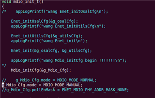

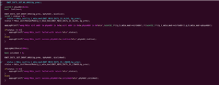

      Mdio_Cfg g_Mdio_Cfg;
      EnetMod_Obj g_mdio_obj = {
      .name = "cpsw2g.mdio",
      .physAddr = 0x46000f00U,
      .features = (ENET_FEAT_BASE |
      MDIO_FEATURE_CLAUSE45),
      .errata = ENET_ERRATA_NONE,
      .open = &Mdio_open,
      .rejoin = &Mdio_rejoin,
      .ioctl = &Mdio_ioctl,
      .close = &Mdio_close,
      EnetMod_Handle g_h_mdio_mod = &g_mdio_obj;
      EnetOsal_Cfg g_osalCfg;
      EnetUtils_Cfg g_utilsCfg;
      Enet_IoctlPrms g_prms;

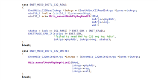

      void scan_phy(){
      int32_t status = 0;
      uint16_t val;
      EnetMdio_C22ReadInArgs inArgs;
      inArgs.group = 0;
      inArgs.reg = 0x01;
      appLogPrintf("wang Mdio_ioctl begin to read reg\n");
      for(uint32_t phyaddr=0;phyaddr<32;phyaddr ++){
      val = 0;
      inArgs.phyAddr=phyaddr;
      ENET_IOCTL_SET_INOUT_ARGS(&g_prms, &inArgs, &val);

    • I try to use mdio like this,mdio_init  mdio_open and dump_reg is ok ,but ioctl  stuck in scan phy ,I find  cmds of ioctl is ok  except  cmd about c22 and c45  .And I find the link_reg and alive reg is 0. Is there something wrong with my code? any config is wrong with mdio or need any other config of mdio?
    for the firmware ,i plan to use linux filesystem and throw ipc to control mcu to control mdio to w/r, is there any better plan to do this?
    the reg dump result:
    You won't be able use MDIO module (MDIO_USER_GROUP_USER_ACCESS_REG) to read/write on MDIO. This is beacuase, the MDIO is being configured in manual mode by linux MDIO driver, which uses bit-banging for MDIO read/write instead of the MDIO_USER_GROUP_USER_ACCESS_REG register.

  • we have try this mode also ,it will call Mdio_manualModePhyRegRead22/Mdio_manualModePhyRegWrite22 func ,but still stuck.Is any code of my demo wrong?
    logs:
    I am not getting where is the code stuck? Is it able to read at least the phy id registers (0x2, 0x3)?

  • it stuck in this:
     status = Mdio_ioctlManualMode(g_h_mdio_mod,ENET_MDIO_IOCTL_IS_ALIVE, &g_prms);
    and this will call Mdio_manualModePhyRegRead22  and stuck in it.
    by the way,i think the patches is useless because we need to implement mdio_read/mdio_write func  of rtl sdk to flush firmware.The flush logic is controled by sdk and it contains parse binary file logic we can not modify it.
    Are you sure that the phy is out of reset for this?
    by the way,i think the patches is useless because we need to implement mdio_read/mdio_write func  of rtl sdk to flash firmware.The flash logic is controled by sdk.
    So this will use the read/write functioned implemented by the mdio driver in the u-boot (you will be using the normal phy mode in u-boot). You can use the phy-driver in uboot to write the firmware to the phy. Then when you boot into the linux kernel, you can configure the link in fixed link and use the ethernet interface normally.
    By the way, does Realtek have a suggestion on how to flash the firmware with linux? like a driver? They might also have solution available for this. So please check with them if you haven't already.
    Tanmay
