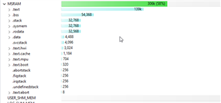

Hi Eli,
For total search for "GRAND TOTAL" for total
and for .text you can see the first column of grand total i.e code size (.text)
OR ELSE
If you are using ccs you go to : view -> memory allocation
It will show you very descriptive memory allocation view.
PS: You need to have project imported in ccs and build once before you can view memory allocation.
