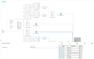

  • Hello Hirano,
    Thank you.
    Since the required is to check the feasibility to generate 8KHz or 16KHz sampling clock, i went ahead with the below analysis:
    Refer the CTT - there is a provision for 100 M or 96 M  clock input to be selected a aux clk.
    With 25 M crystal, the 100 M output is as below
    PLL2_hsdiv8 100 MHz
    With 100 M clock setting the 8KHz or 16KHz sampling rate should be possible. This is based on the CTT analysis and i am not sure if this has been verified or tested.
    Refer below the CTT snap shot
    In case 96 M clock is required to be used
    With 25 M crystal, the 96 M output is as below
    PLL1_hsdiv6
    95.99999994039536 MHz
    For 16 KHz the below can be achieved
    15,999.999
    For 8 KHz the below can be achieved
    7,999.99991
    Sreenivasa
