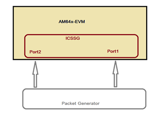

  • Thanks Hideomi for updates,
    What I am planning to try is below.
    1. External Packet generator will Tx frames (Let's say 1000 count).
    2. Then check stats on ICSSG-Port1 and Port2.
    3. It should be  equal to 1000.
    4. With SDK 8.5.0.24
      1. It should PASS
    5. With SDK 8.6.0.45
      1. It should immediately stop and fail
    Is it similar to (bare minimal) what you are trying or let me know your inputs ?
    Best Regards
    Ashwani
  • Hi Ashwani,
    I think very interesting experiment that you have proposed also. And I also would be trying it.
    I would be concerned that it difficult performace to test two ports at the same time. Therefor let's be testing one by one.
    Thanks and regards,
    hideomi
  • I would be concerned that it difficult performace to test two ports at the same time. Therefor let's be testing one by one.
    Thanks Hideomi for update,
    I will make setup and perform test one port at a time.
    Please allow me some time (1-2 days) for this activity and get back to you.
    Best Regards
    Ashwani
  • Hi Ashwani,
    I did the experiment using Corasoft Packet Builder as external generator. Here are the results:
    • Target:  TMDS64GPM    Icssg1-p1
    • Packet Generator:  Corasoft Packet Generator  Version 2.0  (Build 215)
    Packet Data:  2248.Packets.zip
    Packet send:
    As Result:    sdk 8.6.0.45 did not stop but received packets were less than 1000. (389)
    Here I noticed an interesting fact.
    If patch enet_layer2_icssg.c as follow:
    --- enet_layer2_icssg.c	2023-06-27 14:43:39.646007200 +0900
    +++ enet_layer2_icssg.c	2023-06-27 14:26:12.806973600 +0900
    @@ -1679,7 +1679,7 @@
         while ((ENET_SOK == status) && (gEnetMp.run))
    -#if 1
    +#if 0
             /* Wait for 1 milli-sec */
             ClockP_usleep(1000);
     #else
      (loop waiting for pending rx semaphore instaed of sleeping 1msec)
     receive packets became 1000.
    This fact seems to indicate that the receiving behavior depends on design my application, weither sleep or semaphore wait.
    I may need a little more time to investigate this fact carefully.
    Thanks and regards,
    hideomi
