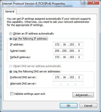

I buy the 6678L EVM.  I run the step of quickstart userguide, but in putty window I never received an IP address and after few minute i received fault for the DHCP status.
At the beginning the DHCP is enable and running but it stay on step for receiving IP address

  • You are connected to a router acting as the DHCP server right?  If you are connected directly to the PC, you will have to use the static IP configuration by changing the EVM user switch settings.  I've never used putty, but tera term works fine for me.  I guess you are past that though since you are seeing the DHCP status error in the putty console, right?

  • I'm connect directly to the PC.  I setup the TCP/IPv4 like this
    I check in the Technical Reference document but I never foun the switch to setup it with static IP
    In the network activity I only have sent packet but no received packet
  • The info for the static IP is found in the getting started guide:
    It can use either a static IP address (pre-configured) or it can request one using
    DHCP. This is controlled by setting User Switch 2 to ON for DHCP and OFF for Static. See SW9.
    Going off memory, I think the static IP will be 192.168.2.100, but you should check to make sure.  You'll need to assign your PC an IP on the same subnet like: 192.168.2. 101
