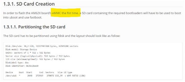

I have a SK-AM62 E2 EVM and I have installed android into it's eMMC using the steps mentioned in 1.3. Flashing Instruction — Processor SDK AM62x Documentation.

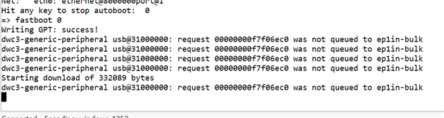

I used the pre built binaries to flash android . It was successfully installed in the eMMC. But now I want to again flash android into eMMC, one of the reason for that is that I want a fresh Android Installation. I again tried following the instructions available in the above page but this time the flashing got stuck at a point stating sending tiboot3.bin
Also following was the output of the UART Terminal.
While going through the SDK's user manual, I found that these instructions are for flashing the eMMC for the first time as u can see that below -
Please help to flash the eMMC again.
