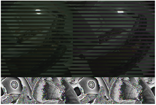

Dear TI expert,
        4 channels surround  view  images are abnormal  when run multi camera app select 4, save 4 raw image:
Please enter number of cameras to be enabled
4
      4_channel_raw.rar

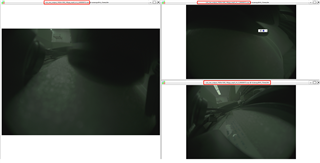

but  images are abnormal  when run multi camera app select 1 channel
1
Save image is ok:
  • Sorror,  but  images are normal  when run multi camera app select 1 channel
  • log:  session_multi_camera_select _4.rar

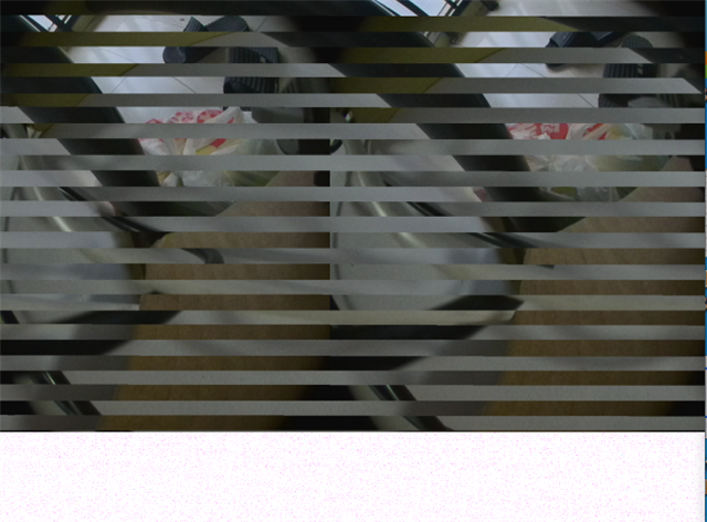

  • 4 channels surround  view  images are abnormal  when run multi camera app select 4, The image:
  •   abnormal  image

  • hi daohong qin,
    There are many overflows, as per below log.
    [MCU2_0]     97.270326 s:  strmFIFOOvflCount[0]: 239
    This could be reason why your 4 channel output is not working..
    0.7G lane speed is not sufficient to receive 4 camera of 1920x1300 resolution at 30fps.. You would require to set minimum 1G lane speed for each lane to receive this data. Also please make sure to set this lane speed even in the deserializer output, because it is not sufficient to set it in just CSIRX.
