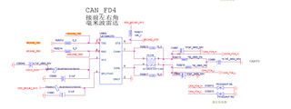

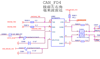

Dear TI:
I use MCAN2 on mcu2-1; I have configured pinmux for TX, RX, and STB pins, and measured that the STB pin has been pulled down; However, the upper computer did not receive the message from MCAN2 and did not detect the baud rate; There is no waveform when measuring CANL and CANH using an oscilloscope; Could you please help me check where the problem is?
thanks

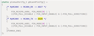

static pinmuxPerCfg_t gMcan4PinCfg[] =
    /* MyMCAN4 -> MCAN4_RX -> AD27 */
        PIN_MCASP0_AXR6, PIN_MODE(0) | \
        ((PIN_PULL_DISABLE | PIN_INPUT_ENABLE) & (~PIN_PULL_DIRECTION))
    /* MyMCAN4 -> MCAN4_TX -> AA28 */
        PIN_MCASP0_AXR5, PIN_MODE(0) | \
    {PINMUX_END}
