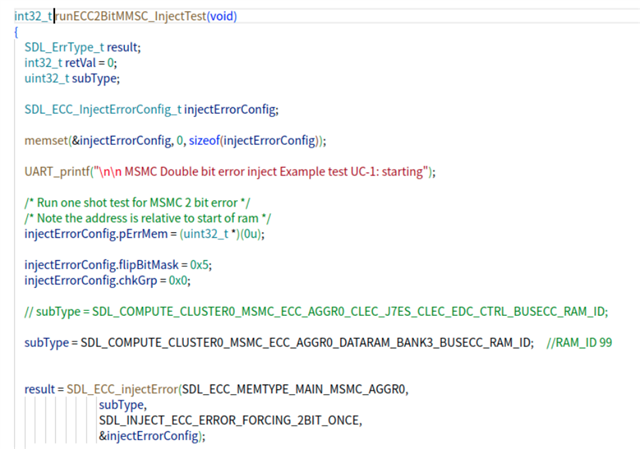

I used the ecc example in the SDL, and test follow the process in the example,I tested the RAM ID in the
COMPUTE_CLUSTER0_MSMC_ECC_AGGR0
For some RAMID it can be injected error sucess and generate ESM interrrupt, but for some RAMID after inject error,it won't generate ESM interrupt. Why? What other information need to config?
The error inject code follow the below code in the ecc_trigger.c

    The standalone test seems to be working. Which SDK are you using? Can you share your source code if there are any modifications you have made? You are building the ecc_app, is that correct?
    Josiitaa
    The SDK version is ti-processor-sdk-rtos-j721e-evm-08_06_00_12.
    I uesd the code in sdl/exmaple/ecc to build ecc_app.
    To test standalone for exmaple  RAMID 99, seems not working.
    In the code,I just modified two places,any other places need to modify?
  • test result
    I am able to reproduce the issue. Checking internally to see if this is expected. I will post an update soon.

    There are two things that you will have to verify before performing a double bit error injection:
    1. Each ECC aggregator has a number of checker groups to identify where the error has occured. Endpoints that have their checker group type as parity do not support double bit error injection. You can verify this in the sdl/include/soc/j721e/sdlr_soc_ecc_aggr.h file. For example RAM ID 95 has 191 checker groups and they all have the checker type as 2u (Parity), hence 2 bit error injection fails.
    2. You must also verify the width of the checker group. For example, in case of RAM ID 97, even though the checker type is not 2 for group 6, the width is 1U, therefore, 2 bit error injection is not possible.
    If any of the checker groups  of a specific RAM ID satisfy both these conditions, then we get a callback or the 2 bit error injection passes.
    Josiitaa
    Thank you for your answer.  I think this resolved my issue.
