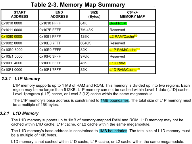

I would like to ask a question on L1 memory.
In page 24 and 50 of spru871k, TMS320C64x+ Megamodule Reference Guide (Rev. K), both L1P and L1D are described to be constrained on 1MB boundaries.
However, on page 14 of sprs345d, TMS320DM6437 Digital Media Processor:
Start Address
Boundary (bytes)
Boundary (bites)
1
L1P RAM/Cache
0x10e0 8000
215 =32 K
256K
2
L1D RAM
0x10F0 4000
214 =16 K
128K
3
L1D RAM/Cache
0x10F1 0000
216 =64 K
512K
Clearly, none of the three is 1MB boundary. So how should I understand spru871k’s description in view of the real L1P/L1D layout of DM6437?
