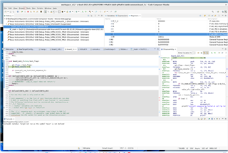

Execute step6: The output is the same as the document. But executing the step7 does not have any output information. Find that steps 6 and steps 7 have stopped at
if (initcall_run_list(init_sequence_f))
hang();
What is the reason?

    In the Register view, please remove thumb mode, Core Registers -> CPSR  -> T = 0.
