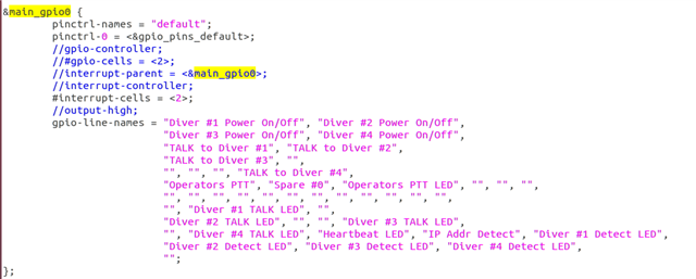

Hello, I am using SK-AM62 Eval board and have made following changes to get the GPIOs labelled and configured as input / output.
Added this to 'main_pmx0'
and then added the GPIO
But still after reboot
