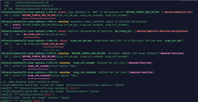

  • "Hello, TI expert! Following this guide, I compiled the corresponding patch and applied it, but I encountered the following error. Could you please advise on how to resolve this error?"
  • Hello Li,
    Are you still using Processor SDK 8.3, and trying to backport the ECAP drivers to that version of Linux?
    Please note that we cannot support backporting drivers to earlier versions of Linux on the forums.
    Whatever you are doing, it looks like there are some missing definitions, so the place where those variables / functions are defined either has not been added, or has not been updated.
    If you want to backport the ECAP support on your own (without help from TI), I would probably:
    1) check out the latest version of the ti-linux-kernel repo
    kernel 6.1: https://git.ti.com/cgit/ti-linux-kernel/ti-linux-kernel/tree/?h=ti-linux-6.1.y-cicd
    kernel 5.10: https://git.ti.com/cgit/ti-linux-kernel/ti-linux-kernel/tree/?h=ti-linux-5.10.y-cicd
    2) search for the files where those variables / functions are defined, e.g. grep -r 'ecap_cnt_pm_ops'
    3) check the git log for those files to make sure you are grabbing every single commit that impacts the ecap support
    Even if you do all that, I cannot guarantee that it will work the way you expect in SDK 8.3, since nobody at TI has validated ECAP on that release.

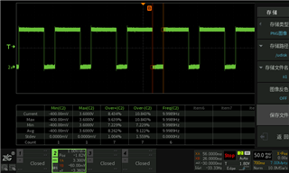

    3) Can you please confirm the signal generator settings?

  • To simplify the problem, I set ecap0 as the PWM output and ecap1 as the capture input. Additionally, my code does not include the patch file you provided, instead, it uses the original ecap code from SDK 08.06.00.42. Here is the device tree file and config file provided, along with the debugging log. However, even after using the "cat capture0" command, the value obtained is still 0.

  • Hello Li,
    Have you verified that you are actually seeing an output on the ECAP PWM output?
    When I reference other devicetree files like k3-am642-evm.dts, it looks like the pinmux settings for ECAP PWM output are still set to PIN_INPUT, even though it is an output signal. I have not had time to check on my side whether PIN_INPUT vs PIN_OUTPUT makes a difference in this usecase.
    Nick
  • Hello Nick,
    I measured the ECAP PWM output using an oscilloscope, and the measurement results are shown in the following figure.
    root@am62xx:/sys/class/pwm/pwmchip0# base/bus@f0000# cd /sys/class/pwm/pwmchip0/
    root@am62xx:/sys/class/pwm/pwmchip0# cat npwm
    1
    root@am62xx:/sys/class/pwm/pwmchip0# echo 0 > export
    root@am62xx:/sys/class/pwm/pwmchip0# cd pwm0
    root@am62xx:/sys/class/pwm/pwmchip0/pwm0# echo 100000000 > period
    root@am62xx:/sys/class/pwm/pwmchip0/pwm0# echo 30000000 > duty_cycle
    root@am62xx:/sys/class/pwm/pwmchip0/pwm0# echo "inversed" > polarity
    root@am62xx:/sys/class/pwm/pwmchip0/pwm0# echo 1 > enable
    root@am62xx:/sys/class/pwm/pwmchip0/pwm0# cat /sys/kernel/debug/pwm
    platform/23010000.pwm, 2 PWM devices
     pwm-0   ((null)              ): period: 0 ns duty: 0 ns polarity: normal
     pwm-1   (backlight           ): requested enabled period: 25000 ns duty: 19607 ns polarity: normal
    platform/23000000.pwm, 2 PWM devices
     pwm-0   (buzzer              ): requested period: 366166 ns duty: 183083 ns polarity: normal
     pwm-1   ((null)              ): period: 0 ns duty: 0 ns polarity: normal
    platform/23100000.pwm, 1 PWM device
     pwm-0   (sysfs               ): requested enabled period: 100000000 ns duty: 30000000 ns polarity: inverse
    Taking into account the above commands, the analysis reveals that the PWM has output a waveform that meets the expected requirements.
    So why is the ecap still not working properly even though the pwm is outputting correctly?
    Li

    From the above log, it can be seen that there are the following two issues:
    Question 1: During the test, there was an error that prevented the test from continuing. May I know the reason behind this error?
    root@am62xx:/opt# ./counter_example > counter_log.txt
    Failed to read event data
    root@am62xx:/opt#
    Question 2:The most important thing is that, according to the method you mentioned above, the calculated PWM period and duty cycle based on the log results are inconsistent with the actual settings.
    Taking one set of data from the aforementioned log as an example:
    cap0: 1688965866
    cap1: 1701465867
    cap2: 1713965868
    cap3: 1726465869
    cap2 - cap0 = 1713965868 - 1688965866 = 25000002
    cap1 - cap0 = 1701465867 - 1688965866 = 12500001
    Inconsistent with the actual settings, as follows:
    Li
