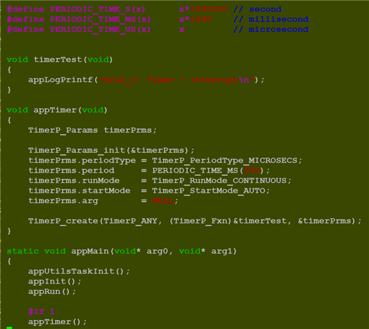

2) If csldmTimer_registerTimerInt is started on appMain of Task, the Timer interrupt has an action, but Task is stuck (printf log in while does not output). However, if csldmTimer_registerTimerInt is started in main, Task can output normally (printf log within while).
The customer will then switch to TimerP.h and now work as expected. But why is there a problem with dmTimer with CSL?
Could you help check this case? Thanks.
