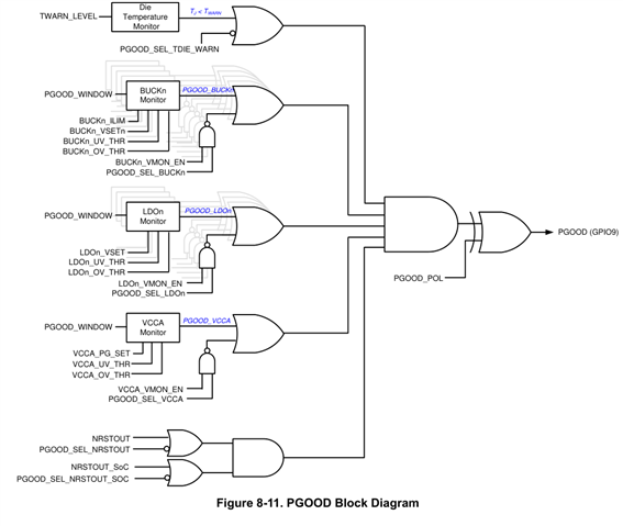

AM62A Low-Power SK EVM User’s Guide points out two ways to power off. I wonder whether the power down sequence of AM62A can be followed when such sudden power loss occurs. It seems the TPS6593 will immediately shut down.

We did this change on the E2 version - Routing LDO_3V3 (Type C PD controller LDO output) to Pin No 49 (FB_B3) of the PMIC instead of SoC_DVDD3V3. In this way, we got 8.3ms between LDO_3V3 and VCC_3V3_MAIN ramp down which can be utilized by the PMIC to initiate controlled power down sequence.
In E1 version, SoC_DVDD3V3 voltage drops below UVLO too fast (in microseconds) not allowing the PMIC to execute a power down sequence before the power is lost.

According to your reply, I try to figure out what happpened in this situation. Please let me know if I'm wrong.
VCCA input undervoltage monitoring event triggers the power down sequence according according to VCCA_GRP_SEL and x_RAIL_TRIG bits which I think select Orderly shutdown.
You set BUCK3_GRP_SEL to choose a group for BUCK3, and set FSM_TRIG_SEL of this group to Immediate shutdown. When SoC_DVDD3V3 drops, the BUCK regulator undervoltage event occurs, thus, Immediate shutdown is triggered so that power down sequence is violated.
Hi Zehui,
Yes, as below, FB_B3 can be set as a free resource of Vmon, and this is same as other BUCK OVUV trig(buck error), but it will not cause a immediate shutdown. pls refer to below NVM setting, any furth questions about PMIC 6593 you need open another thread, we will assign another expert to support. thanks a lot.
