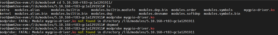

How to install customized driver.ko file?
Customer cp the driver.ko to the sdcard root: /lib/modules/5.10.168-rt83-gc1a1291911, then executed modprobe command, but it prompted can't find the .ko. What's wrong?
It prompted "bad version" when using depmod before modprobe.

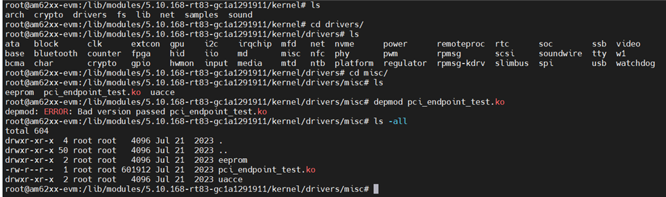

    root@am62xx-evm:/lib/modules/5.10.168-rt83-gc1a1291911/kernel/drivers/misc# modprobe mytest.ko
    modprobe: FATAL: Module mytest.ko not found in directory /lib/modules/5.10.168-rt83-gc1a1291911
    root@am62xx-evm:/lib/modules/5.10.168-rt83-gc1a1291911/kernel/drivers/misc# ls
    eeprom mytest.ko pci_endpoint_test.ko uacce
    root@am62xx-evm:/lib/modules/5.10.168-rt83-gc1a1291911/kernel/drivers/misc# depmod pci_endpoint_test.ko
    depmod: ERROR: Bad version passed pci_endpoint_test.ko
    Besides, customer tried to install the /driver/misc/pci_endpoint_test.ko, but the modprobe is still failed.

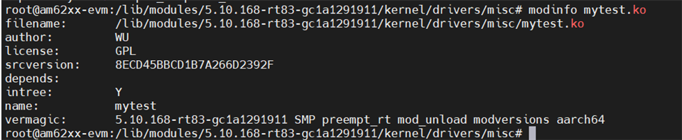

  • Hey Shine,
    Could you attach the output of "modinfo mytest.ko"?
    Randolph
  • Hi Randolph,
    Thank you very much.
    Please see below output.
    Shine
  • Shine,
    That seems to be correct. Just to be sure, you aren't playing around with SELinux or anything that would explicitly want extra attributes attached to the file, right?
    Randolph

  • Hi Shine,
    I just noticed the customer passes a .ko module file to depmod command. This usage is not correct. Please see the explanation of 'depmod <filenames>' in 'man depmod' command.
    "If filenames are given on the command line, only those modules are examined (which is
    rarely useful unless all modules are listed)."
    Actually since the customer has added driver mytest.c to the kernel tree drivers/misc/ folder,  The specific 'depmod' command on EVM is no longer needed, The module dependencies are already generated when 'make ... modules'.
    Please let me know if the customer still has other issues in loading or using mytest.ko.
  • Hi Bin,
    The problem is that it will prompt "not found" when using modprobe  after mounting and installing the mytest.c to /driver/misc. The problem is the same when using msic/pci**.ko.
    Shine
  • Hi Shine,
    Please use command 'modprobe pci_endpoint_test' instead, without '.ko'.
  • Hi Bin,
    Customer's problem has been resolved.
    Thank you very much for your great help.
