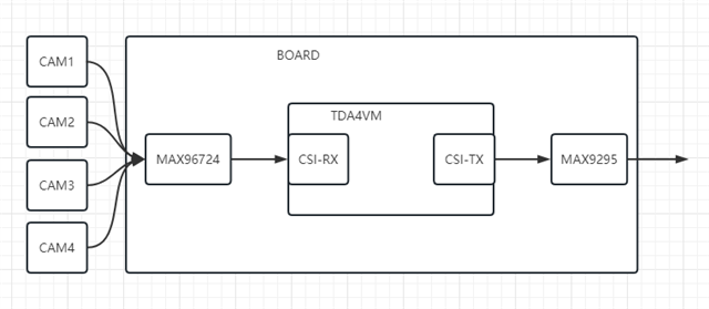

The system is as follows:
4 camera inputs, final 4-screen 1080p CSI-TX outputs.
The customer references and modifies app_multi_cam, the graph is as follows:
1) Capture to M2M are already debugged. (Customer adds a WriteImageNode after M2M node to check the saved file to verify that the mosaIC output is not a problem)
2) max9295 output to their deserializer board (max9296 + HDMI) via coax, showing the green screen.
To locate the issue, the customer wants to have CSI-TX send a piece of data using the test_csitx_csirx routine, and their decode board holds the output data from max9296 and then compares it.
Could you help check this case? Thanks.
