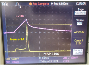

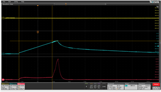

With the new selected part, we have 10% of the production failing. It turns out that at at the very beginning of the CVDD ramp-up, the intial current reported by the IMON_A output of the UCD7442 is twice the amplitude we have on good board and at the end of CVDD rampup, a huge current surge occurs triggering protection, which cause the processor subsystem to shutdown.

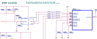

- We looked very closely on possible CORECLK glitches during the rampup process (oscillator in tristate), The following capture shows CVDD, IMON_A and the clock output from the oscillator (differential signal)
- We looked at possibly bad DC-couping capacitor but the common mode voltage before and after the caps are as expected.
