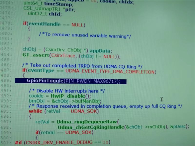

Our customer have done an experienment about CSIRX module drop frame count. They insert an I-O Toggle into the callback function of frame capture(CsirxDrv_udmaCQEventCb).

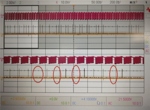

They tested the waveform of MIPI and I-O Toggle.
Normally when MIPI's signal ends, the frame capture process node is in processing and go into the callback function, then I-O will be toggled. So you can see that I-O toggle will happen in the  corner of the MIPI. But when power on, during the initial period, I-O toggle will happen in the middle of the MIPI waveform. They add a drop count frame code in the driver and find that when I-O toggle happen in wrong place, drop count value will be not 0.
So does Driver layer drop the frame occasionally in the CSIRX module, especially for the initial period of power on?

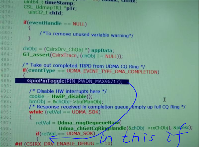

    actually they did another test, they change the I-O toggle to I-O pulse and change the code position to the IF branch as below:
    and the waveform is as below:
    As you can see, the I-O pulse need to occur in every corner of the MIPI waveform, but there lacks of several I-O pulse when power on.
    This scenario seems more like dropping frame. Appreciate your help and look forward to your reply.

  • Hi Zekun,
    Well the driver marks these frames as erroneous in below code. But i dont think this is being used in the OpenVX node. Can you please check for this error in the Fvid2_Frame and see if this error (FVID2_FRAME_STATUS_ERROR) is getting set?
                            /* check only 'STATUS_TYPE' fields of TR response */
                            if ((CSL_REG32_RD(pTrResp) & 0xFU) != 0U)
                                if ((chObj->status == CSIRX_DRV_CH_STATE_STOPPING) ||
                                    (chObj->status == CSIRX_DRV_CH_STATE_STOPPED))
                                    /* Aborted frame due to forced teardown at
                                       Udma_chDisable() */
                                    qObj->frm->status = (uint32_t)FVID2_FRAME_STATUS_ABORTED;
                                else
                                    /* Received frame is either truncated/elongated */
                                    qObj->frm->status = (uint32_t)FVID2_FRAME_STATUS_ERROR;
                                    chObj->instObj->status.errorFrameCount[chObj->chCfg->chId]++;
    Also early end of frame is not normal scenario.. This is not coming from CSIRX, so it will not be explained in the TRM. CSIRX is a receiver, it is just detecting these frame markers.
