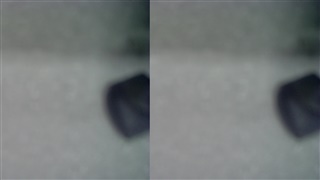

The data I collected from the camera is in YUV422 format, with a resolution of 3840*2160.
I want to use the DSS m2m module, scale it to 1920*1080 resolution, and convert the format to NV12.
But I found that the converted image is incorrect. The converted image only has half the content of the original image, and the left and right halves of the image are the same.
But when I convert an image with format YUV422 and resolution 1920*1080 to 1280*720 and format NV12, there is no problem.
So, does the DSS m2m module support scaling and format conversion at 3840*2160 resolution?

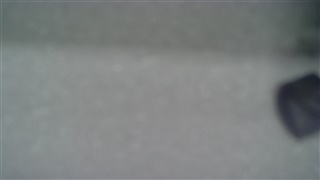

    I just gave it a try and only did format conversion without scaling. But the problem remains the same.
    This is the original image.
    This is the image after format conversion.
    This is the DSS m2m node I created and its corresponding configuration.

  • Hi, Brijesh
    These are several situations that I am currently aware of.
    YUV422 3840*2160 -------format and scale-------> YUV420 1920*1080    FAILED
    YUV422 3840*2160 -------format-------> YUV420 3840*2160                    FAILED
    YUV422 3840*2160 -------scale-------> YUV422 1920*1080                      FAILED
    YUV422 3840*1080 -------scale-------> YUV422 1920*1080                      SUCCESSED
    Tao

    Good news!
    After I use 3-tap filter, The following two situations can be successful.
    YUV422 3840*2160 -------scale-------> YUV422 1920*1080       SUCCESSED
    YUV422 3840*2160 -------format------> YUV420 3840*2160       SUCCESSED
    But when I tried to complete the conversion and scaling all at once, the program got stuck.
    YUV422 3840*2160 -------scale and format------> YUV420 1920*1080   FAILED
    Then I tried to do it in two steps, the first step was to achieve scaling, the second step was to achieve format conversion, and then I obtained an image with a resolution of 1920*1080 and a format of YUV420, and the data was correct.
    YUV422 1920*1080 -------format------> YUV420 1920*1080       SUCCESSED
    At present, although it needs to be completed in two steps, I have achieved the desired result anyway. Thank you for your support. Of course, I still want to ask, do you know why scaling and conversion cannot be completed simultaneously?
