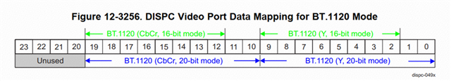

These correspond to the data map mentioned in the manual:

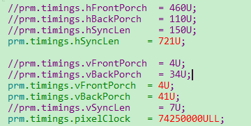

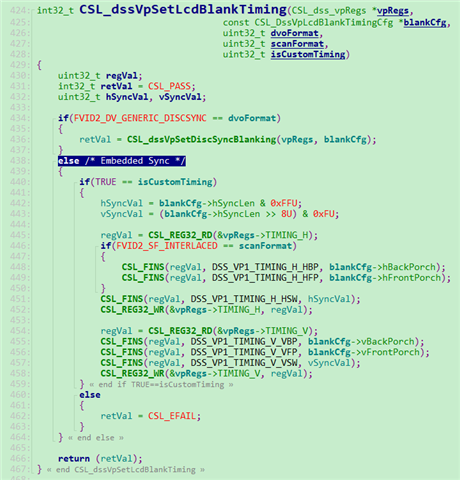

    1) It's found that the code set the timing in csl_dssVideoPort.c 的CSL_dssVpSetLcdBlankTiming function.
    dvoFormat = BT1120 so enter 438 line else
    At the same time, scamFormat = FVID2_SF_PROGRESSIVE,  hBackPorch  hFrontPorch do not set the correspond register, only hSyncVal is being used when checking the code.
    So they modified prm.timings.hSyncLen = 720U;  in app_init.c: appInit() (Sum of row blanking)
    Why is there no register setting for the blankCfg->vSyncLen  field sync in the function?

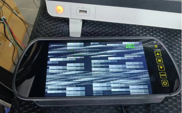

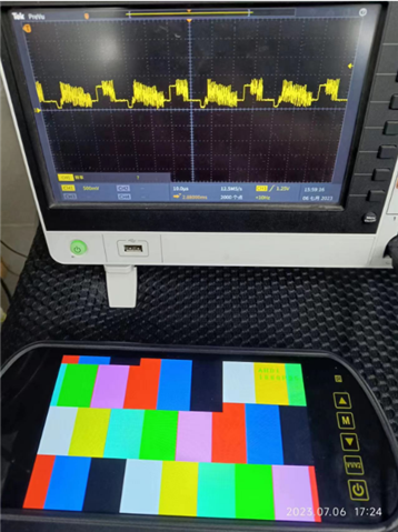

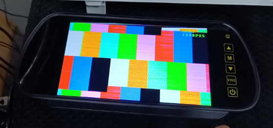

    Test the TDA2 colorbar again, as shown below:
    The color is good, but there is a misalignment.
    2) Using APP_DCTRL_VIFW_24BIT to test TDA2 colorbar is as same as the above figure.

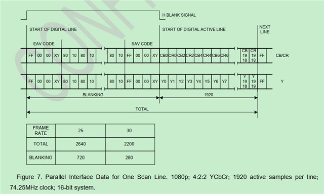

    For the embedded sync, ie BT1120 output format, there is no front porch or back porch. It just contains distance from EAV to SAV code and this can be specificied using hsyncLen and vsyncLen.
    Regarding VBP and VFP, they are just vertical blanking in BT mode. Please refer to below register description for more details.

    As per the NVP6021 manual,
    app_init.c: appInit() modified timing as follows:

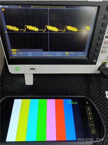

    And review the NVP6021 VOUT output signal through oscilloscope:
    1) Enable the colorbar of NVP6021.
    2) Turn off the colorbar test output of NVP6021 and enable the colorbar of TDA2VM.
    As you can see the cycles are the same, but the contents are different. So they suspected the output data from BT1120 is wrong and synchronization is good.

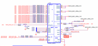

  • I am sure it is VOUT0 output. Here is a screenshot of part of our schematic diagram

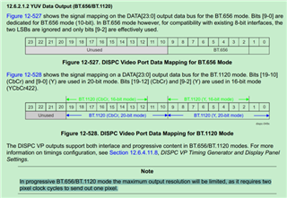

  • There were a number of typos of TDA2VM in the previous description, but to correct this, TDA4VM is used.
  • ” it requires two pixel clock cycles to send out one pixel.“
    Could this be the problem? I'm looking at the TDA4VM datasheet and the code
    This should not be an issue for BT1120 format, as this requires just one clock cycle to output a pixel.

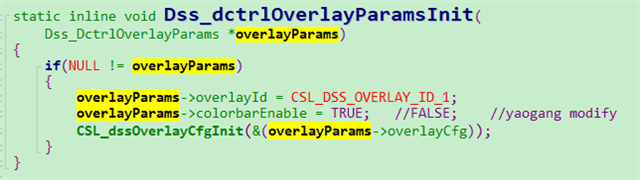

  • enable color bar

    app_dctrl.h :
    Dss_dctrlOverlayParamsInit()
        if(NULL != overlayParams)
            overlayParams->overlayId = CSL_DSS_OVERLAY_ID_1;
            overlayParams->colorbarEnable = TRUE;	//yaogang modify
            CSL_dssOverlayCfgInit(&(overlayParams->overlayCfg));
