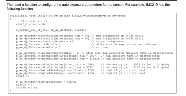

1) AE How to generate exposure table
Hi Li Liu,
Could you clarify which exposure table you're referring to and what you're attempting to accomplish?
You may check out this thread as it might apply to your question: https://e2e.ti.com/support/processors-group/processors/f/processors-forum/1224255/how-to-set-ae-table-about-exposure-time-and-gain-control/4623947?tisearch=e2e-sitesearch&keymatch=exposure%2520table#4623947
Thank you for your reply
From the documentation, it seems that it only defines the exposure time range setting and gain value range setting for AE exposure.
But there is no indication of whether the priority is to increase gain or exposure time when enhancing brightness
When to use gain to enhance the brightness and when to use exposure time to enhance the brightness
In other words, there are only exposure limits, but not the order
