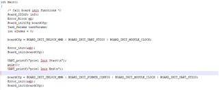

A customer experienced a problem when attempting to transfer the PCIe initialization code from the SBL to the application area in an RTOS running environment.
If the initialization code of the same sequence is executed in the SBL, it works well, but if you move to the App area, the initialization is not completed.

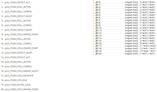

They checked the PCIe LTSSM Status values at the time of the problem, and it is as follows.
They tracked it by referring to the initialization routine of TRM, and after setting LTSSM_EN to 1 in STEP13, the EP Register value is changed to Reset value.
The strange thing is that the PCIe_SS1_EP_CFG_DBICS Registers have been configured , then set LTSSM_EN to 1 and check Link-up as final step, so I'm asking because it's strange behaviuour that the registers are changed to Reset values.
I'm attaching the code they used,
Please check their PCIe initialization code called in the app area, e.g. pcie()
Then let us know if there's anything need to reflect in the code.

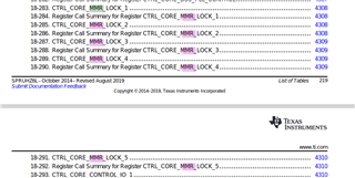

  • Hi Seounguk and Jack,
    That is a good catch. You are right, this is not getting called for AM572x. However, I am still thinking that this could be related to registers being write protected due to some sort of locking mechanism, whether it is some clock registers or some registers controlling the mode at which the PCIe slots should operate. There are some MMR lock registers like below in the technical reference manual for AM572x.

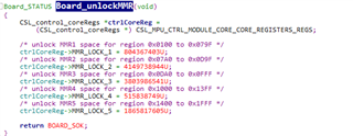

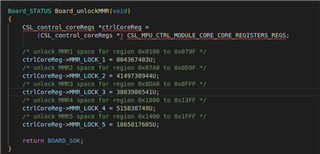

    There is also a function in <AM57 RTOS SDK>/pdk*/packages/ti/board/src/evmAM572x/evmAM572x.c Board_unlockMMR(void) that unlocks all the MMR registers.
    Could you try unlocking these registers for driver initialization and relocking them afterwards? I assume that there is some control MMR registers that are being changed in the driver, and since these are unlocked during board initialization the driver can correctly operate. And in user application area, these registers are locked, so if the driver is trying to change some of these registers, it will fail.

    [Another question]
    After pcie() is called in SBL, the following code is executed.
    boardCfg |= BOARD_INIT_PINMUX_CONFIG |
    BOARD_INIT_DDR |
    BOARD_INIT_DDR_ECC |
    BOARD_INIT_UART_STDIO;
    Board_init(boardCfg);
    /* enable clocks for slave core modules. */
    SBL_SlaveCorePrcmEnable();
    CSL_a15WbAllDataCache();
    if (idkAM572xEntry.entryPoint_MPU_CPU1 != 0)
    /* Bring the A15 CPU1 core out of reset. */
    SBL_MPU_CPU1_BringUp(idkAM572xEntry.entryPoint_MPU_CPU1);
    if (idkAM572xEntry.entryPoint_DSP1 != 0)
    /* Release the DSP1 core out of reset */
    SBL_DSP1_BringUp(idkAM572xEntry.entryPoint_DSP1);
    if (idkAM572xEntry.entryPoint_DSP2 != 0)
    /* Release the DSP2 core out of reset */
    SBL_DSP2_BringUp(idkAM572xEntry.entryPoint_DSP2);
    if (idkAM572xEntry.entryPoint_IPU1_CPU0 != 0)
    /* Release the IPU1 core out of reset and set the Entry point */
    SBL_IPU1_CPU0_BringUp(idkAM572xEntry.entryPoint_IPU1_CPU0);
    if (idkAM572xEntry.entryPoint_IPU1_CPU1 != 0)
    SBL_IPU1_CPU1_BringUp(idkAM572xEntry.entryPoint_IPU1_CPU1);
    if (idkAM572xEntry.entryPoint_IPU2_CPU0 != 0)
    /* Release the IPU2 core out of reset and set the Entry point */
    SBL_IPU2_CPU0_BringUp(idkAM572xEntry.entryPoint_IPU2_CPU0);
    if (idkAM572xEntry.entryPoint_IPU2_CPU1 != 0)
    /* Release the IPU2 CPU1 core out of reset and set the Entry point */
    SBL_IPU2_CPU1_BringUp(idkAM572xEntry.entryPoint_IPU2_CPU1);
    After executing this code, I move on to the application. Was there any factor that could affect this code?

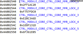

  • The register value was checked at the time of APP startup.
    Verified that all MMR registers are in unlock state.
    In the current implementation code, the MMR register was implemented in a unlock state.
  • Hi Seounguk,
    To close my suspicions on these CTRL MMR registers, could you dump the following registers for the working version where PCIe is set up in SBL and compare with the non-working version where the application is doing initialization?
    And as a final experiment, could you explicitly unlock the MMR registers in the application and do the PCIe initialization, in case these lock registers are configured to read back the same value regardless of whether they are locked or unlocked?
    Takuma
  • Hi Seounguk,
    To give more context to my previous post, these registers should be the ones that are locked/unlocked by CTRL_MODULE_CORE_CTRL_CORE_MMR_LOCK_5, so they should have the same register settings as in the working version of the driver.
    And usually there is a need to explicitly unlock these MMR lock registers when trying to make changes to MMR registers from user space, so I think the experiment would be worthwhile.
    Takuma
