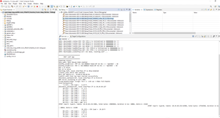

TMDS64EVM: enet lwip ICSSG example poor iperf performance
Part Number: TMDS64EVM
CCS v12.1 + MCU+ SDK v08.06.00.43
Running enet_lwip_icssg_am64x_evm_r5fss0-0_freertos_ti-arm-clang example
Connected the lower ICSSG ethernet port through a TPLink gigabit switch to a PC running Windows 10 and iperf v2.0.9-win64
Given the example output I was expecting 100Mbits/sec at around 50% CPU usage but instead getting around 50Mbits/s at around 100% CPU usage . I need GbE running at full speed so what is causing the poor performance from the R5F core ? What release of the 08.06 MCU+ SDK was the example tested with ?
TMDS64EVM output

IPERF report: type=2, remote: 195.198.8.236:5001, total bytes: 10314924, duration in ms: 13745, kbits/s: 6000
                                  45.149s : CPU load =  97.89 %
     50.149s : CPU load =  97.29 %
IPERF report: type=0, remote: 195.198.8.236:1751, total bytes: 114819096, duration in ms: 20062, kbits/s: 45784

PC output
C:\Users\Jon\Downloads\iperf-2.0.9-win64\iperf-2.0.9-win64>iperf -c 195.198.8.234 -i 5 -t 20 -d
Server listening on TCP port 5001
TCP window size:  208 KByte (default)
Client connecting to 195.198.8.234, TCP port 5001
[  4] local 195.198.8.236 port 1751 connected with 195.198.8.234 port 5001
[  5] local 195.198.8.236 port 5001 connected with 195.198.8.234 port 59266
[ ID] Interval       Transfer     Bandwidth
[  4]  0.0- 5.0 sec  17.1 MBytes  28.7 Mbits/sec
[  4]  5.0-10.0 sec  31.0 MBytes  52.0 Mbits/sec
[  4] 10.0-15.0 sec  30.8 MBytes  51.6 Mbits/sec
[  4] 15.0-20.0 sec  30.5 MBytes  51.2 Mbits/sec
[  4]  0.0-20.0 sec   110 MBytes  45.9 Mbits/sec

    Sorry for the delay I've been busy on other projects. Updated results below. I've swapped to a Netgear GS108 switch and BB router for the DHCP. Any update from your end on fixing this issue ?
    Many thanks,
    Jon
    TMDS64EVM output
    Starting NULL Bootloader ...
    DMSC Firmware Version 8.6.4--v08.06.04 (Chill Capybar
    DMSC Firmware revision 0x8
    DMSC ABI revision 3.1
    INFO: Bootloader_runCpu:155: CPU r5f1-0  is initialized to 800000000 Hz !!!
    INFO: Bootloader_runCpu:155: CPU r5f1-1 is initialized to 800000000 Hz !!!
    INFO: Bootloader_runCpu:155: CPU m4f0-0 is initialized to 400000000 Hz !!!
    INFO: Bootloader_runCpu:155: CPU a530-0 is initialized to 800000000 Hz !!!
    INFO: Bootloader_runCpu:155: CPU a530-1 is initialized to 800000000 Hz !!!
    INFO: Bootloader_loadSelfCpu:207: CPU r5f0-0 is initialized to 800000000 Hz !!!
    INFO: Bootloader_loadSelfCpu:207: CPU r5f0-1 is initialized to 800000000 Hz !!!
    INFO: Bootloader_runSelfCpu:217: All done, reseting self ...
          ENET LWIP App
    Enabling clocks!
    Mdio_open: MDIO Manual_Mode enabled
    EnetPhy_bindDriver: PHY 15: OUI:080028 Model:0f Ver:01 <-> 'dp83869' : OK
    EnetPhy_bindDriver: PHY 3: OUI:080028 Model:0f Ver:01 <-> 'dp83869' : OK
    PHY 3 is alive
    PHY 15 is alive
    Starting lwIP, local interface IP is dhcp-enabled
    [LWIPIF_LWIP] NETIF INIT SUCCESS
    Host MAC address-0 : 34:08:e1:80:b7:b3
    [LWIPIF_LWIP] Enet has been started successfully
    [0]status_callback==UP, local interface IP is 0.0.0.0
    UDP server listening on port 5001
    Icssg_handleLinkUp: icssg1: Port 1: Link up: 1-Gbps Full-Duplex
    link_callback==UP
    [0]status_callback==UP, local interface IP is 192.168.1.6
          5.157s : CPU load =   4.17 %
         10.157s : CPU load =   3.70 %
         15.157s : CPU load =   3.56 %
         20.157s : CPU load =   3.68 %
         25.157s : CPU load =   3.58 %
         30.157s : CPU load =   3.68 %
         35.157s : CPU load =   3.72 %
         40.157s : CPU load =   3.58 %
         45.157s : CPU load =   3.69 %
         50.157s : CPU load =   3.58 %
         55.157s : CPU load =   3.69 %
         60.157s : CPU load =   3.70 %
         65.157s : CPU load =  64.76 %
         70.157s : CPU load =  98.97 %
         75.157s : CPU load =  98.17 %
         80.157s : CPU load =  99.30 %
    IPERF report: type=1, remote: 192.168.1.42:5001, total bytes: 98368984, duration in ms: 20000, kbits/s: 39344
                                                                                                                 IPERF report: type=0, remote: 192.168.1.42:1420, total bytes: 3014680, duration in ms: 20071, kbits/s: 1200
                                                                                       85.157s : CPU load =  39.19 %
         90.157s : CPU load =   4. 8 %
         95.157s : CPU load =   5.74 %
    [  1]  0.0-10.0 sec  1.25 MBytes  1.05 Mbits/sec     0/  893 (0.0e-308%)
        100.157s : CPU load =   5.63 %
        105.157s : CPU load =   5.74 %
    [  1]  0.0-20.0 sec  2.50 MBytes  1.05 Mbits/sec     0/ 1785 (0.0e-308%)
        110.157s : CPU load =  22.34 %
        115.157s : CPU load = 100. 0 %
        120.157s : CPU load = 100. 0 %
        125.157s : CPU load = 100. 0 %
        130.157s : CPU load = 100. 0 %
        135.157s : CPU load =  33.94 %
        140.157s : CPU load =   3.70 %
        145.157s : CPU load =   3.70 %
        150.157s : CPU load =   3.59 %
        155.157s : CPU load =   3.71 %
        160.157s : CPU load =   3.60 %
        165.157s : CPU load =   3.71 %
        170.157s : CPU load =   3.61 %
    UDP test passed Successfully
        175.157s : CPU load =  29.71 %
        180.157s : CPU load =  56.41 %
        185.157s : CPU load =  45.80 %
        190.157s : CPU load =  54.17 %
        195.157s : CPU load =  28.51 %
        200.157s : CPU load =   3.72 %
        205.157s : CPU load =  74.12 %
        210.157s : CPU load =  98.87 %
        215.157s : CPU load =  98.41 %
        220.157s : CPU load =  99.36 %
    IPERF report: type=1, remote: 192.168.1.42:5001, total bytes: 98147064, duration in ms: 20000, kbits/s: 39256
                                                                                                                 IPERF report: type=0, remote: 192.168.1.42:1728, total bytes: 2415234, duration in ms: 20105, kbits/s: 960
                                                                                     225.157s : CPU load =  27.41 %
        230.157s : CPU load =   3.73 %
        235.157s : CPU load =   3.60 %
        240.157s : CPU load =   3.72 %
        245.157s : CPU load =  11.46 %
        250.157s : CPU load =  98.66 %
    IPERF report: type=0, remote: 192.168.1.42:1757, total bytes: 67520064, duration in ms: 10037, kbits/s: 53816
                                                                                                                     255.157s : CPU load =  97.51 %
        260.157s : CPU load =  99.34 %
    IPERF report: type=1, remote: 192.168.1.42:5001, total bytes: 50145184, duration in ms: 10000, kbits/s: 40112
                                                                                                                     265.157s : CPU load =  92.85 %
        270.157s : CPU load =  19.24 %
        275.157s : CPU load =  51.84 %
    [  2]  0.0-10.0 sec  74.2 MBytes  62.3 Mbits/sec  535814/588767 (91%)
        280.157s : CPU load =  67.21 %
        285.157s : CPU load = 100. 0 %
        290.157s : CPU load =  92.79 %
        295.157s : CPU load =   3.58 %
        300.157s : CPU load =   3.74 %
        305.157s : CPU load =   3.61 %
        310.157s : CPU load =   3.75 %
        315.157s : CPU load =   3.77 %
        320.157s : CPU load =   3.59 %

    UART log
          ENET LWIP App
    Enabling clocks!
    PHY 3 is alive
    PHY 15 is alive
    link_callback==UP
          5.158s : CPU load =   4.15 %
         10.158s : CPU load =   3.69 %
         15.158s : CPU load =   3.56 %
         20.158s : CPU load =   3.69 %
         25.158s : CPU load =   3.56 %
         30.158s : CPU load =   3.68 %
         35.158s : CPU load =   3.69 %
         40.158s : CPU load =   3.57 %
         45.158s : CPU load =   3.69 %
         50.158s : CPU load =   3.57 %
         55.158s : CPU load =   3.68 %
         60.158s : CPU load =   3.68 %
         65.158s : CPU load =   3.56 %
         70.158s : CPU load =   3.70 %
         75.158s : CPU load =   3.57 %
         80.158s : CPU load =   3.68 %
         85.158s : CPU load =   3.59 %
         90.158s : CPU load =   3.69 %
         95.158s : CPU load =   3.69 %
        100.158s : CPU load =   3.57 %
        105.158s : CPU load =   3.68 %
        110.158s : CPU load =   3.57 %
        115.158s : CPU load =   3.69 %
        120.158s : CPU load =   3.69 %
        125.158s : CPU load =   3.57 %
        130.158s : CPU load =   3.69 %
        135.158s : CPU load =   3.59 %
        140.158s : CPU load =   3.69 %
        145.158s : CPU load =   3.69 %
        150.158s : CPU load =   3.57 %
        155.158s : CPU load =   3.68 %
        160.158s : CPU load =   3.57 %
        165.158s : CPU load =   3.69 %
        170.158s : CPU load =   3.64 %
        175.158s : CPU load =   3.69 %
        180.158s : CPU load =   3.69 %
        185.158s : CPU load =   3.57 %
        190.158s : CPU load =   3.70 %
        195.158s : CPU load =   3.57 %
        200.158s : CPU load =   3.70 %
        205.158s : CPU load =   3.71 %
        210.158s : CPU load =   3.57 %
        215.158s : CPU load =   3.70 %
        220.158s : CPU load =   3.57 %
        225.158s : CPU load =   3.71 %
        230.158s : CPU load =   3.77 %
        235.158s : CPU load =   3.60 %
        240.158s : CPU load =   3.72 %
        245.158s : CPU load =   3.85 %
    [0]status_callback==UP, local interface IP is 192.168.1.65
        250.158s : CPU load =   3.77 %
        255.158s : CPU load =   3.58 %
        260.158s : CPU load =   3.69 %
        265.158s : CPU load =   3.68 %
        270.158s : CPU load =  27.65 %
        275.158s : CPU load =  97.68 %
        280.158s : CPU load =  96.12 %
        285.158s : CPU load =  98.16 %
        290.158s : CPU load =  95.23 %
        295.158s : CPU load =  97.69 %
    IPERF report: type=0, remote: 192.168.1.64:10020, total bytes: 198836248, durati                                     on in ms: 30056, kbits/s: 52920
                                       300.158s : CPU load =  73. 9 %
        305.158s : CPU load =   3.62 %
    IPERF report: type=2, remote: 192.168.1.64:5001, total bytes: 10974, duration in                                      ms: 9692, kbits/s: 8
                             310.158s : CPU load =   3.73 %
        315.158s : CPU load =   3.99 %
        320.158s : CPU load =  11.12 %
    [  1]  0.0-10.0 sec  10.3 MBytes  8.63 Mbits/sec    14/ 7356 (0.19%)
    [  1]  0.0-10.0 sec  10.3 MBytes  8.62 Mbits/sec    14/ 7356 (0.19%)
        325.158s : CPU load =  13.75 %
        330.158s : CPU load = 100. 0 %
        335.158s : CPU load = 100. 0 %
        340.158s : CPU load =  24.22 %
        345.158s : CPU load =   3.72 %
        350.158s : CPU load =   3.70 %
        355.158s : CPU load =   3.58 %
        360.158s : CPU load =   3.70 %
        365.158s : CPU load =   3.58 %
        370.158s : CPU load =   3.69 %
        375.158s : CPU load =   3.69 %
        380.158s : CPU load =   3.57 %
        385.158s : CPU load =   3.69 %
        390.158s : CPU load =   3.57 %
        395.158s : CPU load =   3.70 %
        400.158s : CPU load =   3.72 %
        405.158s : CPU load =   3.58 %
        410.158s : CPU load =   3.70 %
        415.158s : CPU load =   3.58 %
        420.158s : CPU load =   3.70 %
        425.158s : CPU load =   3.57 %
        430.158s : CPU load =   3.70 %
        435.158s : CPU load =   3.69 %
        440.158s : CPU load =   3.57 %
        445.158s : CPU load =   3.72 %
        450.158s : CPU load =   3.58 %
        455.158s : CPU load =   3.71 %
        460.158s : CPU load =   3.70 %
        465.158s : CPU load =   3.59 %
        470.158s : CPU load =   3.69 %
        475.158s : CPU load =   3.58 %
        480.158s : CPU load =   3.70 %
        485.158s : CPU load =   3.69 %
        490.158s : CPU load =   3.57 %
        495.158s : CPU load =   3.69 %
        500.158s : CPU load =   3.57 %
        505.158s : CPU load =   3.69 %
        510.158s : CPU load =   3.57 %
        515.158s : CPU load =   3.69 %
        520.158s : CPU load =   3.69 %
        525.158s : CPU load =   3.56 %
        530.158s : CPU load =   3.69 %
        535.158s : CPU load =   3.60 %
        540.158s : CPU load =   3.75 %
        545.158s : CPU load =   3.70 %
        550.158s : CPU load =   3.58 %
        555.158s : CPU load =   3.69 %
        560.158s : CPU load =   3.59 %
        565.158s : CPU load =   3.69 %
        570.158s : CPU load =   3.69 %
        575.158s : CPU load =   3.58 %
        580.158s : CPU load =   3.71 %
        585.158s : CPU load =  17.81 %
        590.158s : CPU load =  58. 3 %
    got
            595.158s : CPU load =  76. 6 %
        600.158s : CPU load =  68.81 %
        605.158s : CPU load =  88.54 %
        610.158s : CPU load =  96.92 %
    IPERF report: type=0, remote: 192.168.1.64:63374, total bytes: 158203928, durati                                     on in ms: 30079, kbits/s: 42072
                                       615.158s : CPU load =  66.33 %
        620.158s : CPU load =   3.61 %
    IPERF report: type=2, remote: 192.168.1.64:5001, total bytes: 10974, duration in ms: 9919, kbits/s: 8
                                                                                                             625.158s : CPU load =  15.64 %
        630.158s : CPU load =  97.72 %
        635.158s : CPU load =  96.45 %
        640.158s : CPU load =  96.76 %
        645.158s : CPU load =  96.92 %
        650.158s : CPU load =  96.50 %
    IPERF report: type=0, remote: 192.168.1.64:63650, total bytes: 199098392, duration in ms: 30055, kbits/s: 52992
                                                                                                                       655.158s : CPU load =  86.53 %
        660.158s : CPU load =   3.64 %
    IPERF report: type=2, remote: 192.168.1.64:5001, total bytes: 10974, duration in ms: 9922, kbits/s: 8
                                                                                                             665.158s : CPU load =   3.75 %
        670.158s : CPU load =   3.58 %
        675.158s : CPU load =   3.69 %
          ENET LWIP App
    Enabling clocks!
    Mdio_open:282
    EnetPhy_bindDriver:1717
    PHY 3 is alive
    PHY 15 is alive
    Icssg_handleLinkUp:2583
    link_callback==UP
          5.145s : CPU load =   2. 6 %
         10.145s : CPU load =   1.67 %
         15.145s : CPU load =  12.11 %
         20.145s : CPU load =  40.88 %
         25.145s : CPU load =  41.43 %
         30.145s : CPU load =  41.91 %
         35.145s : CPU load =  40.82 %
         40.145s : CPU load =  41.51 %
    IPERF report: type=0, remote: 192.168.1.64:63790, total bytes: 288227352, duration in ms: 30028, kbits/s: 76784
                                                                                                                        45.145s : CPU load =  29.45 %
         50.145s : CPU load =   1.58 %
    IPERF report: type=2, remote: 192.168.1.64:5001, total bytes: 10974, duration in ms: 9717, kbits/s: 8
                                                                                                              55.145s : CPU load =   1.68 %
         60.145s : CPU load =   1.66 %
         65.145s : CPU load =   1.56 %
         70.145s : CPU load =   1.66 %
         75.145s : CPU load =   1.56 %
         80.145s : CPU load =   1.66 %
         85.145s : CPU load =   1.56 %
         90.145s : CPU load =   1.66 %
         95.145s : CPU load =   1.66 %
        100.145s : CPU load =   2. 0 %
        105.145s : CPU load =   4.94 %
    [  1]  0.0-10.0 sec  11.1 MBytes  9.27 Mbits/sec   323/ 8214 (3.9%)
        110.145s : CPU load =  16.59 %
        115.145s : CPU load = 100. 0 %
        120.145s : CPU load = 100. 0 %
        125.145s : CPU load =  25.87 %
        130.145s : CPU load =   1.67 %
        135.145s : CPU load =   1.57 %
        140.145s : CPU load =   1.66 %
        145.145s : CPU load =   1.66 %
        150.145s : CPU load =   1.57 %
        155.145s : CPU load =   1.66 %
        160.145s : CPU load =   1.56 %
        165.145s : CPU load =   1.66 %
        170.145s : CPU load =   1.57 %
        175.145s : CPU load =   1.66 %
        180.145s : CPU load =   1.66 %
        185.145s : CPU load =   1.56 %
        190.145s : CPU load =   1.66 %
        195.145s : CPU load =   1.56 %
        200.145s : CPU load =   1.66 %
        205.145s : CPU load =   1.66 %
        210.145s : CPU load =   1.56 %
        215.145s : CPU load =   1.66 %
        220.145s : CPU load =   1.56 %
        225.145s : CPU load =   1.66 %
        230.145s : CPU load =   1.66 %
        235.145s : CPU load =   1.56 %
        240.145s : CPU load =   1.66 %

    Sending 1470 byte datagrams, IPG target: 131.94 us (kalman adjust)
    UDP buffer size:  208 KByte (default)
    recvack failed: Resource temporarily unavailable
    [  4] local 10.0.4.15 port 51114 connected with 192.168.1.64 port 5001 (server version is old)
    [  4]  0.0-10.0 sec  32.6 MBytes  27.3 Mbits/sec
    [  4] 10.0-20.0 sec  46.1 MBytes  38.7 Mbits/sec
    [  4] 20.0-30.0 sec  47.3 MBytes  39.7 Mbits/sec
    [  4]  0.0-32.6 sec   136 MBytes  35.0 Mbits/sec
    [  4] Sent 97011 datagrams
    [  4] Server Report:
    [  4] 0.00-842.22 sec  4.00 GBytes  40.8 Mbits/sec  131.072 ms 3906653023526450248/3761972673589018652 (1e+02%) -/-/-/- ms    1 pps
    [  4] 0.00-842.22 sec  1 datagrams received out-of-order
    ubuntu@ubuntu:~/Downloads/iperf-2.0.13$
