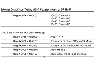

We are going to test Ethernet(100 BASE-Tx Mode 5 MDI) on AM62-SK EVM.
We use the way as below after referring to “How to Configure DP838xx for Ethernet Compliance Testing.pdf”:
Ethernet:
  1. devmem2 0x001F w 0x8000
  2. devmem2 0x0000 w 0x2100
  3. devmem2 0x0010 w 0x5008
  4. devmem2 0x0009 w 0xBB00
  5. devmem2 0x0025 w 0x0480
Step #2, #3 work well, but #1, #4, #5 return “Bus error” message.

  • Hi Schuyler,
    Thanks for your information.
    Depending on the table below:
    I manipulate these registors above sequencely.
    After writing 0x0480 into Reg 0x0025 using phytool, I try to read Reg 0x0025 and I still get the value of 0x0000.
    Why is the value of Reg 0x0025 as 0x0000 not 0x0480??
    I also confirm that the values of Reg 0x0000, Reg 0x0010 and Reg 0x0009 are same as the ones I write.

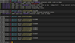

  • Hi Kylix,
    See the following FAQ for using phytool. Please share the screenshots of your terminal, I would like to verify the correct syntax is being used.
    Can you read registers other than 0x25? For example, 0x1, 0x2, 0x3?
    Other than this, is the PHY operation working as expected? Is there link up and packet transfer happening?
    David
  • Hi David,
    1. The below is the screenshot of my terminal:
    2. I can read other registers other than 0x25. Please refer to the screenshot.

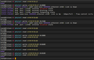

    3. Before executing phytool:
      After executing phytool:
      Depending on the above both screenshots, RX and TX packages have been changed after executing phytool.

  • Hi Kylix,
    I see the issue. Phytool is not set up to automatically read extended registers (>0x1F). 0x0025 is an extended register, so the process described in section 8.4.2.1 of the datasheet must be used to write this register. Let me know if this solves the issue.
    David
  • Hi David,
    I refer to the section 8.4.2.1 of the datesheet and give a try. I successfully write the value I wanted into the register 0x0025.
    Thanks.
