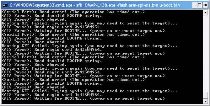

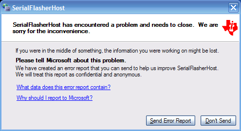

Hello all,
               I am using Zoom EVM development board with OMAP L138. Initially I could serial flash the spi(around 10 times ). But later sfh_OMAP_L138.exe -erase  did not work. after leaving the board idle for half hour i could erase the flash . after erasing when i use this command sfh_OMAP_L138.exe -flash arm-spi-ais.bin u-boot.bin its reporting error. please help me out i have attached the error report to this post.. I have tried to spi flash many times..

  • HI Satish,
                     I have set the DIP switches S7:7 and S7:8 to on while flashing the unit. So DIP switch settings are correct.

  • Satish,
    ZOOM board worked fine till date.. I did not do any flashing through CCS.. Next day it just worked fine.. Now from morning after trying for long hours got booted up once.. now its not booting up... i could not reproduce the problem.. I have no idea whats happening with the board.
    Later I tried to connect the board through CCS 4 with xds 100v2.
    with S7:5 and 8 ON. after loading gel file when i tried to connect the target i got this error...
