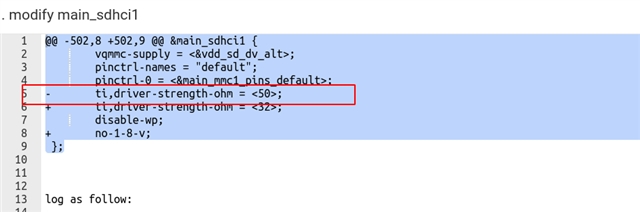

I use the default TI codes to make a new SD file. The number of Board PROC112A1 can bring up and enter linux system, which has no EMMC checked by hard-enginer of my teamer. But our designed board(which have EMMC and SD) will stop at " Waiting for root device PARTUUID=6d813a05-02..." using the same SD file.
1. u-boot can check EMMC and SD, printing the addr at logs . it first bring up from EMMC when entering linux while mmc is 1 from bootargs.

4. I refer to a related question https://e2e.ti.com/support/processors-group/processors/f/processors-forum/1206195/dra821u-sbl-how-can-i-boot-to-linux-from-sd-card-without-emmc/4586681?tisearch=e2e-sitesearch&keymatch=TDA4%25252525252525252520start%25252525252525252520from%25252525252525252520sd#4586681 .
4.1 close main_sdhci0 is no useful for the error "mmc0: mmc_select_hs200 failed, error -110"
4.2 add "no-1-8-V" is no useful , i also add "no-1-2-v" is still no useful for the error "mmc0: mmc_select_hs200 failed, error -110"
4.3 if I change code flow at mmc_select_timing is useful for the error "mmc0: mmc_select_hs200 failed, error -110". but still stop at "Waiting for root device PARTUUID=6d813a05-02..."
@@ -1512,11 +1512,13 @@ static int mmc_select_timing(struct mmc_card *card) if (!mmc_can_ext_csd(card)) goto bus_speed; +#if 0 if (card->mmc_avail_type & EXT_CSD_CARD_TYPE_HS400ES) err = mmc_select_hs400es(card); else if (card->mmc_avail_type & EXT_CSD_CARD_TYPE_HS200) err = mmc_select_hs200(card); else if (card->mmc_avail_type & EXT_CSD_CARD_TYPE_HS) +#endif err = mmc_select_hs(card); if (err && err != -EBADMSG)

Can you help to analysis the reason?
