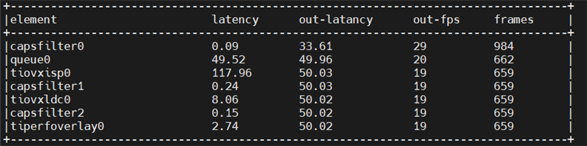

Dear Ti staff,
We are having trouble outputing images from ox05B sensor at top speed.
According to Omnivision, this RGB-IR sensor can output at 60fps, with RGB and IR frames in 30fps each.
With the following gstreamer command, we evaluated the latency using the gst_tracer:
1. Streaming RGB frames:
gst-launch-1.0 \
v4l2src device=/dev/video2 io-mode=5 ! \
video/x-bayer, width=2592, height=1944, format=bggi10 ! queue leaky=2 ! \
tiovxisp sensor-name=SENSOR_OX05B_RGBIR \
dcc-isp-file=/opt/imaging/ox05b/dcc_viss.bin \
sink_0::dcc-2a-file=/opt/imaging/ox05b/dcc_2a.bin sink_0::device=/dev/v4l-subdev2 format-msb=9 \
sink_0::pool-size=8 src::pool-size=8 ! \
video/x-raw, format=NV12 ! tiovxldc dcc-file=/opt/imaging/ox05b/dcc_ldc.bin sensor-name=SENSOR_OX05B_RGBIR ! \
video/x-raw, format=NV12, width=1920, height=1080 , framerate=60/1 ! \
tiperfoverlay main-title="TI EdgeAI Hirain" title="Camera Demo" ! \
kmssink driver-name=tidss sync=false
the result was:

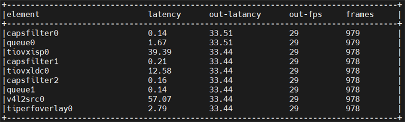

2. Streaming IR frames:
gst-launch-1.0 \
v4l2src device=/dev/video3 io-mode=5 ! \
tiovxisp using_ir_mode=True sensor-name=SENSOR_OX05B_RGBIR \
video/x-raw, format=GRAY8, width=2592, height=1944 ! videoconvert ! \
video/x-raw, format=NV12, width=1920, height=1080, framerate=60/1 ! \
the result was:
I'm not sure the final pipeline structure we'll be using for the application, but our current commands for testing are facing severe performance issue. We would like to ask for some help regarding this problem, here are some related information:
1. Our goal is to output RGB or IR frames in 30fps seperately, whether using kmssink or filesink.
2. ISP algorithm for IR frames should be under development at the moment, so we are trying to use the algorithm for RGB frames instead, which seems to cause dramatic latency.
3. The 'using_ir_mode‘ parameter was added by me to distinguish the stream source, in order to invoke correponding v4l2 controls to adjust the exposure parameters. Theoratically this modifications should not affect the frame rate, but we'll try to confirm it by testing on the original setup.
Thank you for the support in advance and looking forward to your reply.
Huang Jingjie

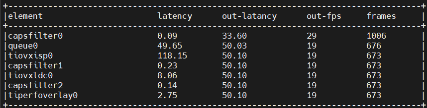

  • Hi Jianzhong,
    I’ve run the test with the original driver provided by omnivision and here are the details:
    1. the streaming command is as follows:
    GST_DEBUG_FILE=/run/trace.log GST_DEBUG_NO_COLOR=1 GST_DEBUG="GST_TRACER:7" GST_TRACERS="latency(flags=element)" \
    gst-launch-1.0 \
    video/x-raw, format=NV12, width=1920, height=1080 ! \
    2. the result on gst tracer is almost the same as privious result with our modified driver:
    3. the output of ps -ef, there doesn't seems to be other thread consuming the core. And even if I use renice to reset the priority, the outcome won't change.

  • Hello Jingjie,
    Thanks for the additional information. To find out what caused the fps drop, can you do a few testing?
    1. Use "fpsdisplaysink" to display the fps instead of using the script "parse_gst_tracers.py". For example, below gst pipeline works on my setup with ov2312:
    root@am62axx-evm:/opt/edgeai-gst-apps# GST_DEBUG_FILE=/run/trace.log GST_DEBUG_NO_COLOR=1 GST_DEBUG="GST_TRACER:7" GST_TRACERS="latency(flags=pipeline+element)" \
    > gst-launch-1.0 -v v4l2src device=/dev/video3 io-mode=5 ! \
    > video/x-bayer, width=1600, height=1300, framerate=30/1, format=bggi10 ! queue leaky=2 ! \
    > tiovxisp sink_0::device=/dev/v4l-subdev4 sensor-name=SENSOR_OV2312_UB953_LI \
    > dcc-isp-file=/opt/imaging/ov2312/dcc_viss.bin sink_0::dcc-2a-file=/opt/imaging/ov2312/dcc_2a.bin format-msb=9 \
    > video/x-raw, format=NV12, width=1600, height=1300, framerate=30/1 ! queue ! \
    > fpsdisplaysink text-overlay=false video-sink="kmssink driver-name=tidss sync=true show-preroll-frame=false" sync=true
    Below is the displayed fps information:
    /GstPipeline:pipeline0/GstFPSDisplaySink:fpsdisplaysink0: last-message = rendered: 15, dropped: 0, current: 29.32, average: 29.32
    /GstPipeline:pipeline0/GstFPSDisplaySink:fpsdisplaysink0: last-message = rendered: 30, dropped: 0, current: 28.13, average: 28.71
    /GstPipeline:pipeline0/GstFPSDisplaySink:fpsdisplaysink0: last-message = rendered: 44, dropped: 0, current: 27.17, average: 28.20
    /GstPipeline:pipeline0/GstFPSDisplaySink:fpsdisplaysink0: last-message = rendered: 58, dropped: 0, current: 27.94, average: 28.14

  • Hi Jianzhong,
    I've tried your way to monitor fps, which didn't work (prints out nothing).
    But I refered your pipeline and used the old way, the output was 30fps.
    Here is the new pipeline for streaming RGB frames:
    gst-launch-1.0 \
    video/x-bayer, width=2592, height=1944, framerate=30/1, format=bggi10 ! queue leaky=2 ! \
    video/x-raw, format=NV12, width=1920, height=1080,framerate=30/1 ! queue ! \
    And here is the trace log:
    Both tiperfoverlay and trace log showed that output framerate was around 30fps.

  • Hi Jingjie,
    Thanks for sharing the updates.
    Looks like adding the queue element made the difference in frame rate.
    More info on IR stream: my colleague confirmed that by using the following pipeline, the board can output IR frames in 30fps(gst_tracer result):
    Do you also get 30fps if you use kmssink?
