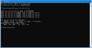

  • Hi Tony,
    Can you ping your board through your PC and share the logs.
    Thanks and Regards,
    Rimika

    Are these the logs observed on ping from PC to board?
    It means we are able to ping the board but as soon as we unplug the USB and plug it back in, it throws 'invalid swdata' ,right?
    Thanks and regards,
    Rimika
  • Are these the logs observed on ping from PC to board?
    Thanks and regards,
    yes.
    A USB hub chip flew above the SDRAM chip, and the USB HUB chip was moved to the side of the SDRAM chip. When plugging and unplugging the USB, the probability of network interface abnormalities was much lower.
