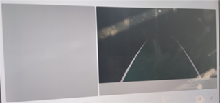

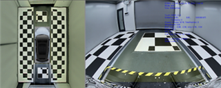

Recently, in order to solve the problem of blurred screens, we upgraded the GPU driver of TDA4. A new rendering issue has occurred, SRV is allowed to stand for 10 minutes before entering(Active), and the SRV component rendering is incomplete.
Expected rendering result:
Incorrect rendering result:

// avmStatus : 0: Inactive, 1: Active.
// If avmStatus is always 1, we got correct rendering result.
// If avmStatus(== 0) is input for about 10 minutes, then input avmStatus(== 1), we will get an incomplete rendering result.
    What is the upgrade that you did? Which SDK version are you on and which SDK version did you take the GPU driver from?
    Did this work before, and now it is not working after the GPU driver update?
