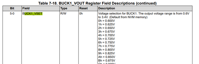

i2cget -y 0 0x30 0x0a
0x8a (0x8a shows that the voltage is 0.85V, measuring using DMM also gives 0.85V)
