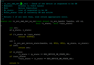

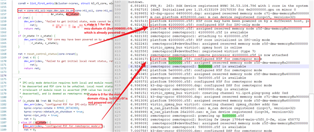

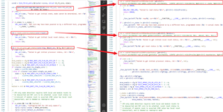

and we are porting the driver to initialize the R5F core, and met a problem (the linux version is OK),
in our software flow, we use the SCI function to query the R5 status by the similar method on Linux:
static int k3_r5_rproc_configure_mode(struct k3_r5_rproc *kproc)
//drivers\remoteproc\ti_k3_r5_remoteproc.c
ret = core->ti_sci->ops.dev_ops.is_on(core->ti_sci, core->ti_sci_id,
					      &r_state, &c_state);
if (r_state != c_state) {
		dev_warn(cdev, "R5F core may have been powered on by a different host, programmed state (%d) != actual state (%d)\n",
			 r_state, c_state);
on our software platform, the r_state is 0, but the c_state is 1, that means the R5F core is been powered by a different host, but actually we didn't load R5F image and power on R5F during the initialization stage until now.
(compared with Linux, the c_state is 0, and Linux will configure the R5F for remoteproc mode)
do you know is there any other host will start R5F, e.g. UBOOT?
or is there any other init actions should be done before querying the R5F is on or not?
or  is there any detail R5F start flow materials can be referred.
and also, could you give me some suggestion to check this problem?
really expect your response and great support, thanks a lot

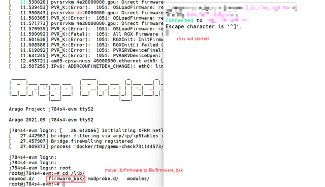

  • ask one more question, if we found r5 is still running, how to reset it?
    The Linux powers up the R5F and loads the firmware under /lib/firmware. You can for testing sake move the /lib/firmware folder on the rootfs of the target folder to /lib/firmware_bk
    Check if still the main domain R5Fs are powered on. Note that MCU domain R5F is mandatory to be on and should run the device manager firmware.
    - Keerthy
  • hello,
    I have tested as your suggestion, move the /lib/firmware to /lib/firmwares_bak. in this case, after Linux start up, there is none any log from R5 serial port. so the R5 is not loaded and started by Linux.
    but when running in our software system (started in uboot), I query the R5 status through the SCI command (messageid =0x201), the current_state in the response message is 1, which means the R5 is already running. but compared with TDA4VM, the current_state is 0 on TDA4VM.
    so I am confused why the R5 is running on TDA4VH? who starts the R5? or is there any init flow must be done before configuring the R5?

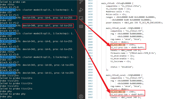

  • Hi Suman,
    Are you sure you are using the right device ids for TDA4VH in your query?
    => I checked the proc id and dev id, I use the id by parsing the dts nodes, So I think it should be correct.
     Do you see this behavior only on a specific MAIN R5F or all of them?
    => all MAIN R5F cores have the same behavior, all 6-cores are running.

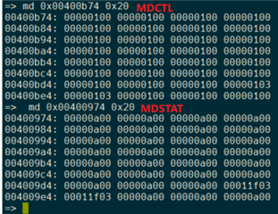

    Please read the following PSC MDCTL and MDSTAT registers which correspond to the MAIN R5F cores.
    The general formula is as follows:
    MDCTL = 0x400000 + 0xA00 + (psc_id * 4)
    MDSTAT = 0x400000 + 0x800 + (psc_id * 4)
    Following are the PSC ids for the MAIN R5F cores:
    MAIN R5FSS0 :  Core0 = 93; Core1 = 94
    MAIN R5FSS1 : Core0 = 96; Core1 = 97
    MAIN R5FSS2 : Core0 = 122; Core1 = 123
    regards
    Suman

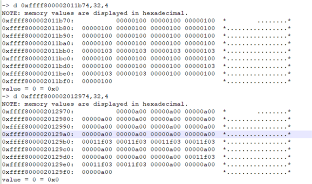

  • Hi Suman,
    => the MAIN R5FSS0 :  Core0 = 93; Core1 = 94, so we can get the address as:
        the MDCTL of core 0 is  0x400 000  + 0xA00 + 0x174 = 0x400 B74
         the MDSTAT of core 0 is 0x400000 + 0x800 + 0x174 =0x400 974
    the dump result is as below picture shows, I dumped the register in the Uboot, the MDCTL value  is 0x100, the MDSTAT  value is 0xa00.
    compared the dump result on TDA4VM: (assume it has the same psc_id on TDA4VM for R5FSS0)
    the MDCTL value is 0x000, the MDSTAT value is 0xa00  => compared on the  TDA4VH, the MDCTL of R5FSS0 is 0x100
    I cannot find the MDCTL register bits-description, and don't know the meaning of the bit8 of MDCTL .
    Could you help to check the difference, and give some comment about the difference. thanks a lot for your kindly support.

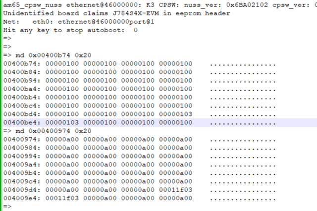

  • Hi Yinli,
    Thank you for capturing the logs.
    The PSC Ids for MAIN R5FSS0 on TDA4VM are the same, as mentioned in the TRM.
    The MDSTAT value of 0xa00 indicates the cores are indeed in reset (global reset). A powered-on state would reflect something like 0x11f03.
    The following are the bit definitions of MDSTAT and MDCTL registers (Please download the J784S4 TRM zip file, this should contain an Excel file with the register definitions, please look through PSC Sheet)
    Bit 8 is Local Reset value.
    The values look normal to me. The core->ti_sci->ops.dev_ops.is_on() alone is not enough to distinguish IPC-only mode. There is additional logic in the code that also relies on the status of local reset and global resets.
    Please see the code logic and my comments in the driver for the same,
             * IPC-only mode detection requires both local and module resets to
             * be deasserted and R5F core to be unhalted. Local reset status is
             * irrelevant if module reset is asserted (POR value has local reset
             * deasserted), and is deemed as remoteproc mode
            if (c_state && !ret && !halted) {
                    dev_err(cdev, "configured R5F for IPC-only mode\n");
                    kproc->rproc->state = RPROC_DETACHED;
                    kproc->rproc->detach_on_shutdown = true;
                    kproc->ipc_only = true;
                    ret = 1;
            } else if (!c_state) {
                    dev_err(cdev, "configured R5F for remoteproc mode\n");

    this picture shows our software flow, the left is the linux reference implementation, and  the right side is our software flow.
    and here is our log:
    the c_state=1, ret=0, halted=1, and it enter the mismatched mode...
     is there any other init flow need to be done before querying and configuring  the R5 mode ?

    => yes, I attached the full log since board power on /cfs-file/__key/communityserver-discussions-components-files/791/2086.dump_5F00_from_5F00_uboot.txt
    Is it possible for you to read the same registers at your OS console instead of at U-Boot? Please disable your remoteproc drivers for this.=> disable remoteproc drivers  and dump regs. /cfs-file/__key/communityserver-discussions-components-files/791/dump_5F00_from_5F00_os.txt
    [MAIN R5FSS0 core0]psc_id = 93, MDCTLVirAddr=0xffff800002011b74, MDSTATVirAddr=0xffff800002012974,MDCTL: [0x00400b74]=0x00000100, MDSTAT: [0x00400974]=0x00000a00
    I have tried on twice tda4vh boards, they have the same status.
    and also I have a question, the c_state is  from the SCI message, and  is there any register can be read to check the value of c_state.
    pSciHandle->ops.pmOps.isDeviceOn (pSciHandle,  (UINT8) pDrvCtrl->tiSciDevId, &r_state, &c_state);

    => md 0x00400b74 0x20
    00400b74: 00000100 00000100 00000100 00000100 ................
    00400b84: 00000100 00000100 00000100 00000100 ................
    00400b94: 00000100 00000100 00000100 00000100 ................
    00400ba4: 00000100 00000100 00000100 00000100 ................
    00400bb4: 00000100 00000100 00000100 00000100 ................
    00400bc4: 00000100 00000100 00000100 00000100 ................
    00400bd4: 00000100 00000100 00000100 00000103 ................
    00400be4: 00000103 00000100 00000100 00000100 ................
    => md 0x00400974 0x20
    00400974: 00000a00 00000a00 00000a00 00000a00 ................
    00400984: 00000a00 00000a00 00000a00 00000a00 ................
    00400994: 00000a00 00000a00 00000a00 00000a00 ................
    004009a4: 00000a00 00000a00 00000a00 00000a00 ................
    004009b4: 00000a00 00000a00 00000a00 00000a00 ................
    004009c4: 00000a00 00000a00 00000a00 00000a00 ................
    004009d4: 00000a00 00000a00 00000a00 00011f03 ................
    004009e4: 00011f03 00000a00 00000a00 00000a00 ................
