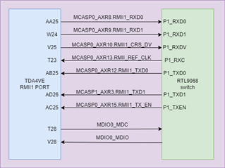

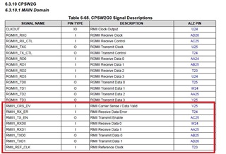

  • HI:
       TDA4VE-Q1。dst:k3-j721S2*
       I tried to modify it, but it didn't work。
       Could you please provide a patch?
    Hardware connection:
    diff path:

    -       rgmii1_pins_default: rgmii1-pins-default {
    +       main_rmii1_pins_default: main-rmii1-pins-default {
                    pinctrl-single,pins = <
    -                       J721S2_IOPAD(0x0a8, PIN_INPUT, 8) /* (U24) MCASP0_AXR14.CLKOUT */
    +                       J721S2_IOPAD(0x0a8, PIN_OUTPUT_PULLUP, 8) /* (U24) MCASP0_AXR14.CLKOUT */
                            J721S2_IOPAD(0x098, PIN_INPUT, 8) /* (V25) MCASP0_AXR10.RMII1_CRS_DV */
    +                       J721S2_IOPAD(0x0a4, PIN_INPUT, 8) /* (T23) MCASP0_AXR13.RMII_REF_CLK */
                            J721S2_IOPAD(0x090, PIN_INPUT, 8) /* (W24) MCASP0_AXR8.RMII1_RXD0 */
                            J721S2_IOPAD(0x094, PIN_INPUT, 8) /* (AA25) MCASP0_AXR9.RMII1_RXD1 */
    -                       J721S2_IOPAD(0x0a0, PIN_INPUT, 8) /* (AB25) MCASP0_AXR12.RMII1_TXD0 */
    -                       J721S2_IOPAD(0x0b0, PIN_INPUT, 8) /* (AD26) MCASP1_AXR3.RMII1_TXD1 */
    -                       J721S2_IOPAD(0x0ac, PIN_INPUT, 8) /* (AC25) MCASP0_AXR15.RMII1_TX_EN */
    +                       J721S2_IOPAD(0x0a0, PIN_OUTPUT, 8) /* (AB25) MCASP0_AXR12.RMII1_TXD0 */
    +                       J721S2_IOPAD(0x0b0, PIN_OUTPUT, 8) /* (AD26) MCASP1_AXR3.RMII1_TXD1 */
    +                       J721S2_IOPAD(0x0ac, PIN_OUTPUT, 8) /* (AC25) MCASP0_AXR15.RMII1_TX_EN */

    log:

    root@j721s2-evm:~# ifconfig eth0
    eth0: flags=4098<BROADCAST,MULTICAST>  mtu 1500  metric 1
            inet 192.168.1.6  netmask 255.255.255.0  broadcast 192.168.1.255
            ether f6:a5:e2:52:f2:a8  txqueuelen 1000  (Ethernet)
            RX packets 0  bytes 0 (0.0 B)
            RX errors 0  dropped 0  overruns 0  frame 0
            TX packets 0  bytes 0 (0.0 B)
            TX errors 0  dropped 0 overruns 0  carrier 0  collisions 0
    root@j721s2-evm:~# ifconfig eth0 192.168.1.9
    SIOCSIFFLAGS: No such device
    root@j721s2-evm:~# ping 192.168.1.5
    PING 192.168.1.5 (192.168.1.5): 56 data bytes
    ping: sendto: Network is unreachable
