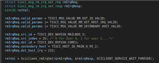

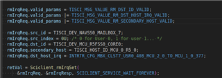

I used J721S2 chip,I try to use IPC to send message.
1、MCU2_1->MCU1_0
I set MCU1_0 IRQ code(from ti demo)
MCU1_0 can receive MCU2_1 Message

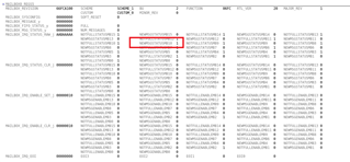

2、MCU10->MCU2_1
MCU2_1 can receive MCU1_0 Message,NO 225 INT RESOURCE  IRQ ?
3,how to mapping INT/IRQ for mailbox?
  • mailbox0 MCU21->MCU10
CLST7_USER0->IN_INTR[408]->INTR_ROUTER0
INTR_ROUTER0
OUTL_INTR[401]->337
INTR_ROUTER0_OUTL_INTR[407:400]
MCU_R5FSS0(core0 /core1)
CORE0/1_INTR_IN_[383:376]
  • mailbox 0 mcu10->  Mcu21
CLST5_USR2->IN_INTR[418]
INTR_ROUTER0
OUTL_INTR[225]->225
INTR_ROUTER0_OUTL_INTR[255:224]
R5FSS0_CORE1
CORE1_INTR_IN_[255:224]
I do not konw IN_INTR mapping to OUTL_INTR?
 can you help me?
