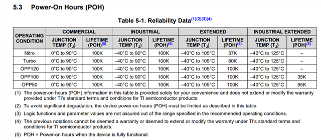

At ambient temperature 60℃(Ta), Measure AM3352BZCZD30 Tc=89℃.
But AM3352BZCZD30 operating temperature range is 0℃ to 90℃。
Does it exceed specification?

Hi Kallikuppa
Yes it is a custom board, design by ourself.
1. The board is in a IP65 Case, thermocouple is fixed on the chip. Then put the case in temperature chamber.
2. Set chamber to 60℃ and power on the board.
3 Chamber temperature hold 60℃ for 4hours.
4 Measure the thermocouple value.

There is an App note (Semiconductor and IC Package Thermal Metrics, SPRA953C) which should provide more guidance.
https://www.ti.com/lit/an/spra953c/spra953c.pdf
3 ΨJT, Junction to Top of Package
I did a quick look and see the following formula for Tj based on Tc
Given that the case temperature is approaching the maximum junction temperature I would say the device may already be out of spec.
Please verify.

Hi Kallikuppa
If I replace with AM3352BZCZA30(-40 to 105), it can meet spec, right?

Hello Liang Paker,
The AM3352BZCZA30(-40 to 105) should offer better thermal performance.
Since you may have the power consumption numbers and the system requirements, you should be able to calculate the TJ and make the selection accordingly.
