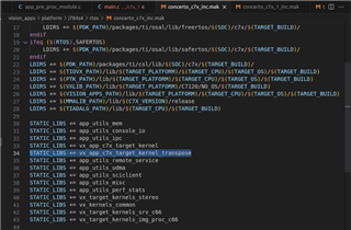

4. I have provided this library as a static_lib in concerto_c7x_inc.mak.

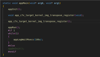

5. The following kernel register function is added in app_main() function within  /ti-processor-sdk-rtos-j784s4-evm-08_06_01_03_lin_rel/vision_apps/platform/j784s4/rtos/c7x_1/main.c:

    Have you used the following in the concerto of vx_app_c7x_target_kernel_transpose
    ifeq ($(TARGET_CPU),$(filter $(TARGET_CPU), x86_64 C71 C7120 C7504))
    Nikhil
  • 1. We tried to update a small piece of code in MMALIB to see if we can build it and found that the target cpu it is considering is different to what it should be. Hence, we weren't sure if this problem is with MMALIB or the way we are building it. I thought this might be of some concern with the original issue we were facing, so mentioned it here. In order to build MMALIB we followed the instructions mentioned here: MMALIB User Guide: MMALIB Build Instructions. we simply used the commands make mmalib inside vision apps and also checked running this command within MMALIB directory.
    2. Yes, we do have the given line mentioned in the concerto of the library.
