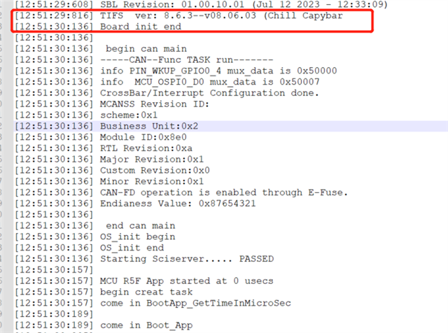

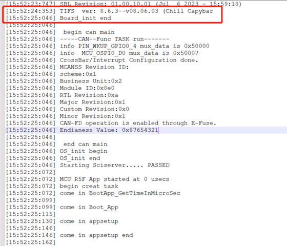

    We use SDK version 8.6, and the startup time for SD card and EMMC is as follows:
time for First log to boardinit
time for boardinit
time for can response
SD
208ms
320ms
528ms
EMMC
606ms
693ms
1299ms
We need a fast response time of less than 500ms for CAN, and currently the startup time using EMMC exceeds 500ms. As shown in the table, how to optimize the first and second column time。
time for First log to boardinit:
SBL Revision: 01.00.10.01----------------------->TIFS  ver: 8.6.3--v08.06.03------------------------------->need to optimized
time for boardinit:
TIFS ver: 8.6.3--v08.06.03 ------------------------->Board_init end-------------------------------------------->need to optimized
time for can response:
SBL Revision: 01.00.10.01-------------------------->end can main
SD log with SBL:
emmc log with SBL:
    time for boardinit
    SD
    208ms
    320ms
    528ms
    EMMC
    606ms
    693ms
    1299ms

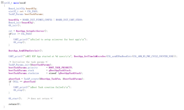

    Could you also let me know where have you put the log Board_init end? Is it after DDR initialization and before loading the app image by SBL?
    Nikhil
        Above mentioned profile timestamps are for eMMC UDA.
        Board_ The position of init is placed in front of BootAPP_SetupSciServer in
    tda4-s2/rtos-sdk/pdk_j721s2/packages/ti/boot/sbl/example/boot_app/boot_app_main.c
    Timestamps following:
