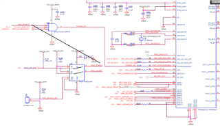

SK-AM62A-LP: How to connect PMIC_LPM_EN0 signal?
Part Number: SK-AM62A-LP
We want to del J9 and TMUX154EDGSR.
Thanks.

  • We want to del J9 and U31(TMUX154EDGSR) in SK-AM62A-LP.
    SEL of TMUX154 is high, so A=A1,B=B1, right? like picture below.
    Maybe we can't know the principle now, we just want to know how to connect, maybe we need some time to understand the principle.
    Thanks.
  • Hello Hui-Liu
    Thank you for the inputs.
    Please refer below mux pin function.
    Understand.
    You could close this thread and start a new thread once you review the function.
    When not sure it would be a good idea to provision during the initial prototype.
    Sreenivasa
