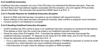

  • I now also witnessed an Undefined exception.
    Contrary to most crashes which happen most often while starting up the ENET (TI MCU+ SDK library supporting Ethernet), this crash happens at the very startup of the R5 core, apperently during I2C opening called from TI board and driver setup :
    CPSR register M[4..0] is 11011 meaning currently in Undefined mode.
    The Link register R14 again makes no sense : 0x00000001.
    From appnote sprad28 :
    Unfortunately, I don't know how to interprete R14 since it's at value 0x1.
    From the call stack which is displayed in the Debug window - if this is correct - then the core was somewhere executing I2C_open() which is located in DDR (0x9000B0B4).
    The DDR itself is first initialized in the SBL NULL bootloader and then again setup in the SysConfig of the project itself.
    kind regards,
    Marc Schouteeten

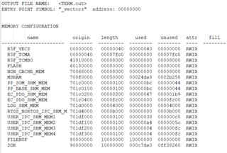

  • I have another occurance of Undefined abort; in another location.
    The reason I'm posting it; is because the call stack shows a strange address : an offset of 0x7d0b470 to a memory area which is big data buffer (not instruction).
    The crash again happens at the very startup of the core. Nothing has been printed yet on the console terminal.
    R14 is again 0x1; while ARM mode in CPSR is 11011 (undefined).
    kind regards,
    Marc

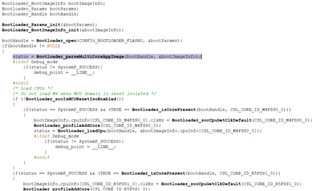

    In the bootloader I noticed that it returns from the following line, and sometimed printed the following debug log:
    if(status == SystemP_SUCCESS)
        status = Bootloader_runSelfCpu(bootHandle, &bootImageInfo);
    /* it should not return here, if it does, then there was some error */
    DebugP_log("All CPU-s initialized.");
    Bootloader_close(bootHandle);
    After boot we synchronize the cores after initialization, to make sure every shared buffer is properly initialized before use.
    The first abort is happens before that in the I2C_open() function as seen above.

  • Hi Lucas,
    Earlier on the exceptions always occurred on the core R5_0_1 which was running a console, tcp/ip stack, emmc, filesystem, etc... This core also uses the DDR quite a lot.
    Now we have a case where the multicore OSPI SBL is failing. We are using a customized version of OSPI SBL which uses our OSPI flash and also DDR. The SBL is derived from the example bootloader provided by TI and is running on core R5_0_0. We see that the crash occurs while parsing the multi core image which was earlier flashed to OSPI flash.
    I cannot see the content of the registers, since here we test using a flashed image. (thus we use the OSPI flash bootloader).
    I am sure that the image itself was flashed correctly; because we first upload the OSPI SBL, app image and app xip image via TFTP PUT to the DDR, then it is saved from DDR to eMMC. After this we again do a TFTP GET where the image is read from eMMC to DDR, then sent via TFTP to the host PC. After comparing the PUT image to the GET image; everything is identical. This is actually a proof of the tcp/ip comm, the ddr and the emmc.
    Still we get this OSPI SBL parsing error at startup.
    We had the issue on 2 hardware boards.
    Another board does not have the issue; but there I see the crashes mentioned above (instruction and data errors).
    kind regards,
    Marc
